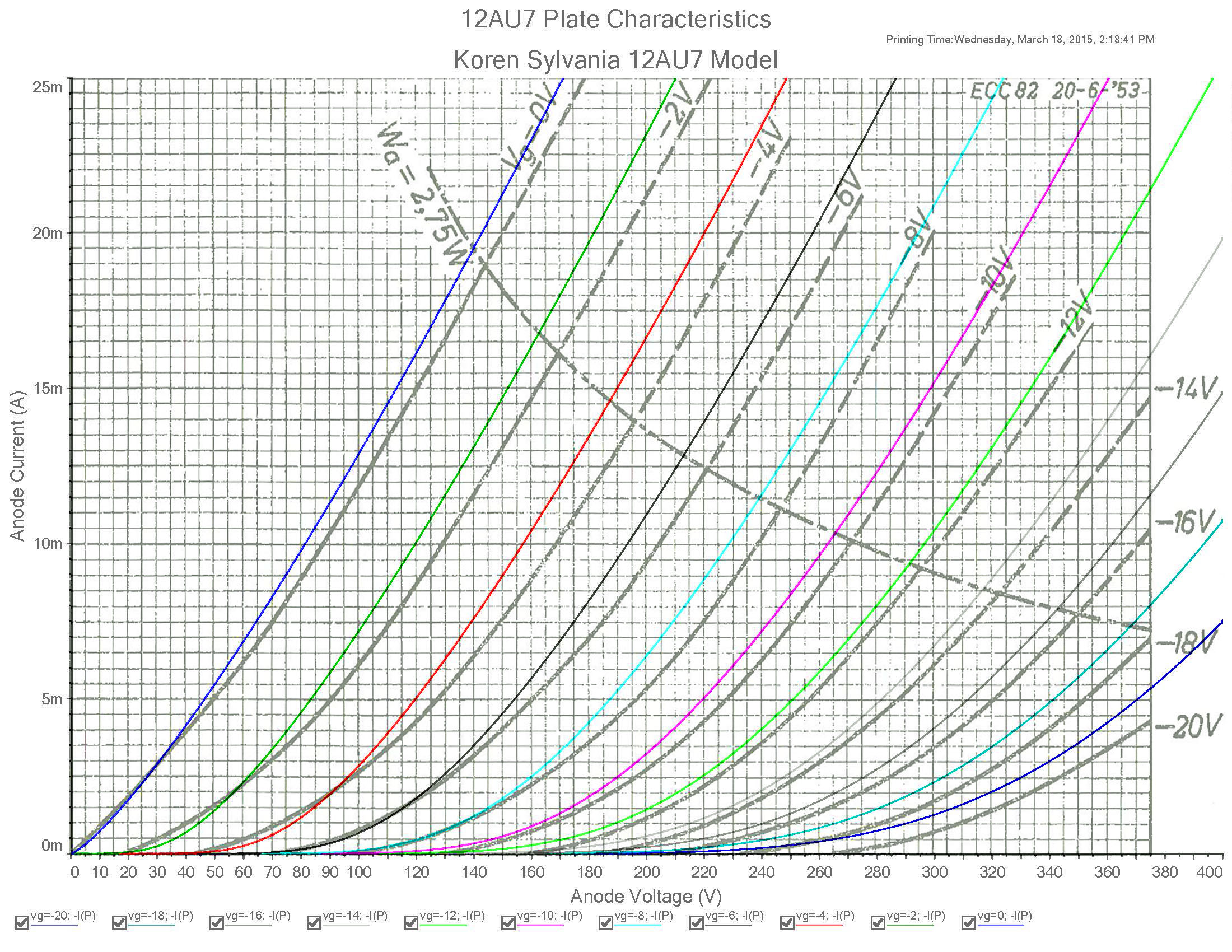

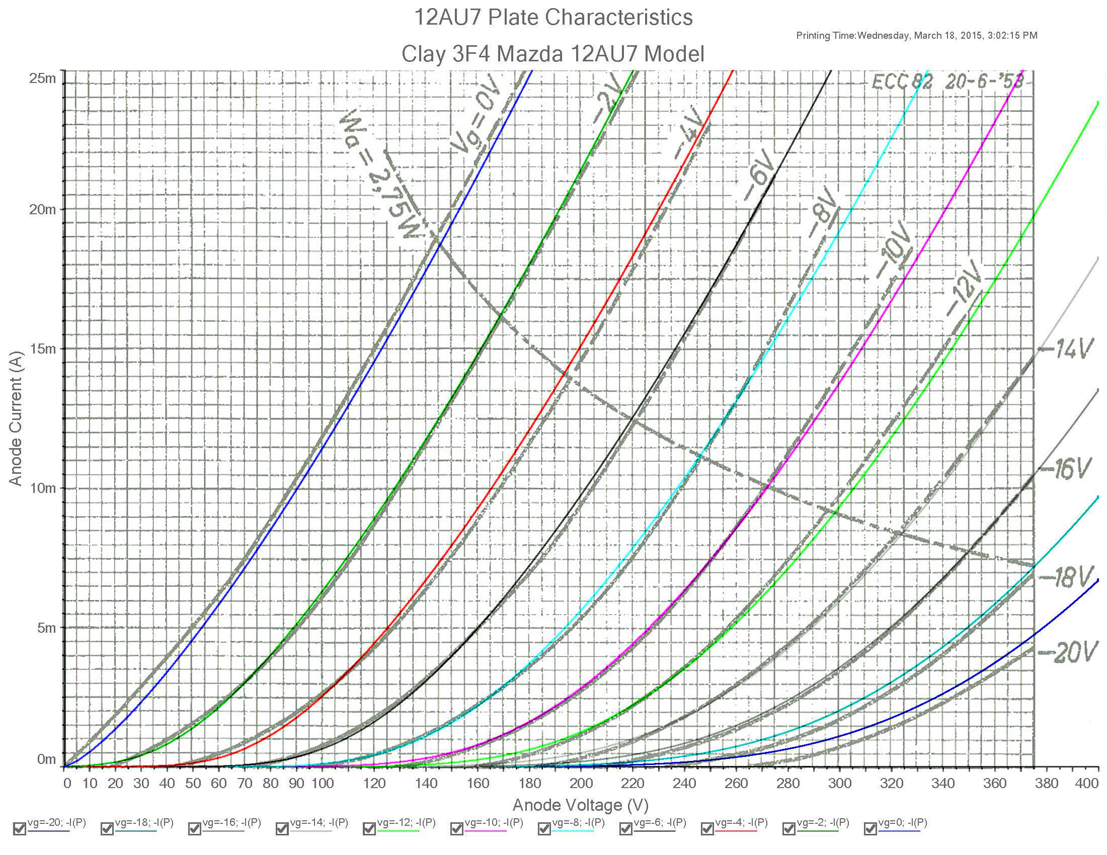

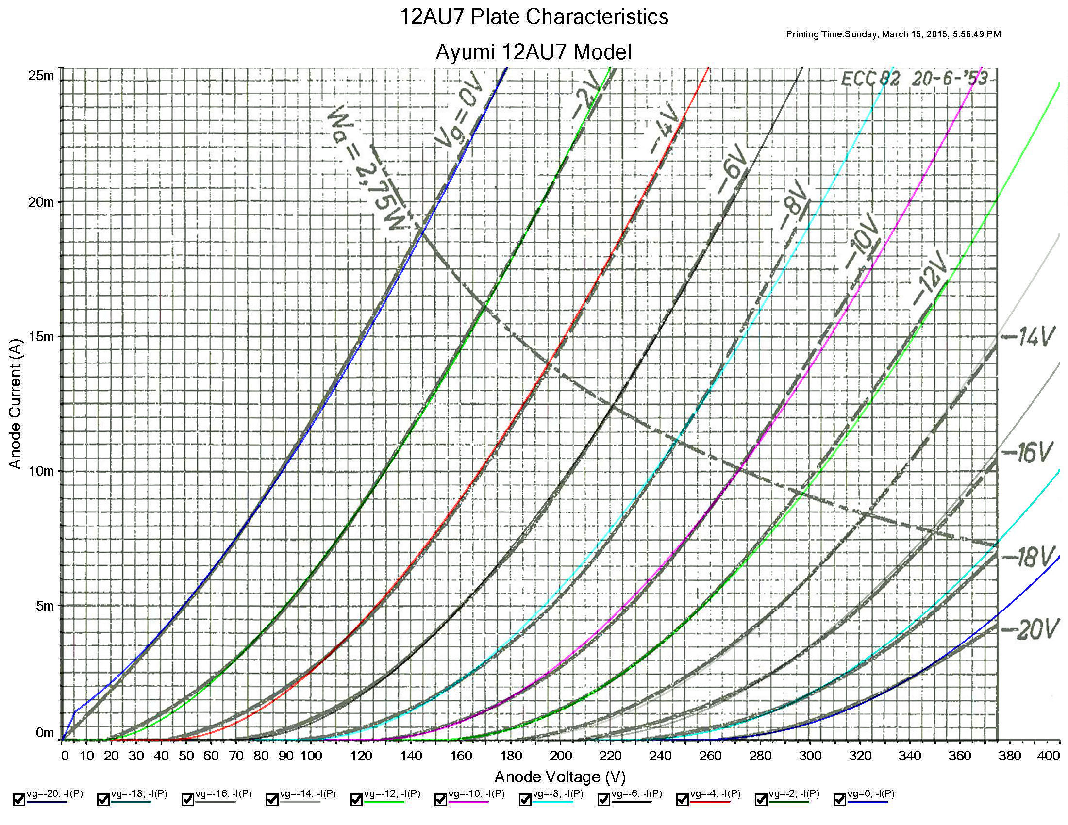

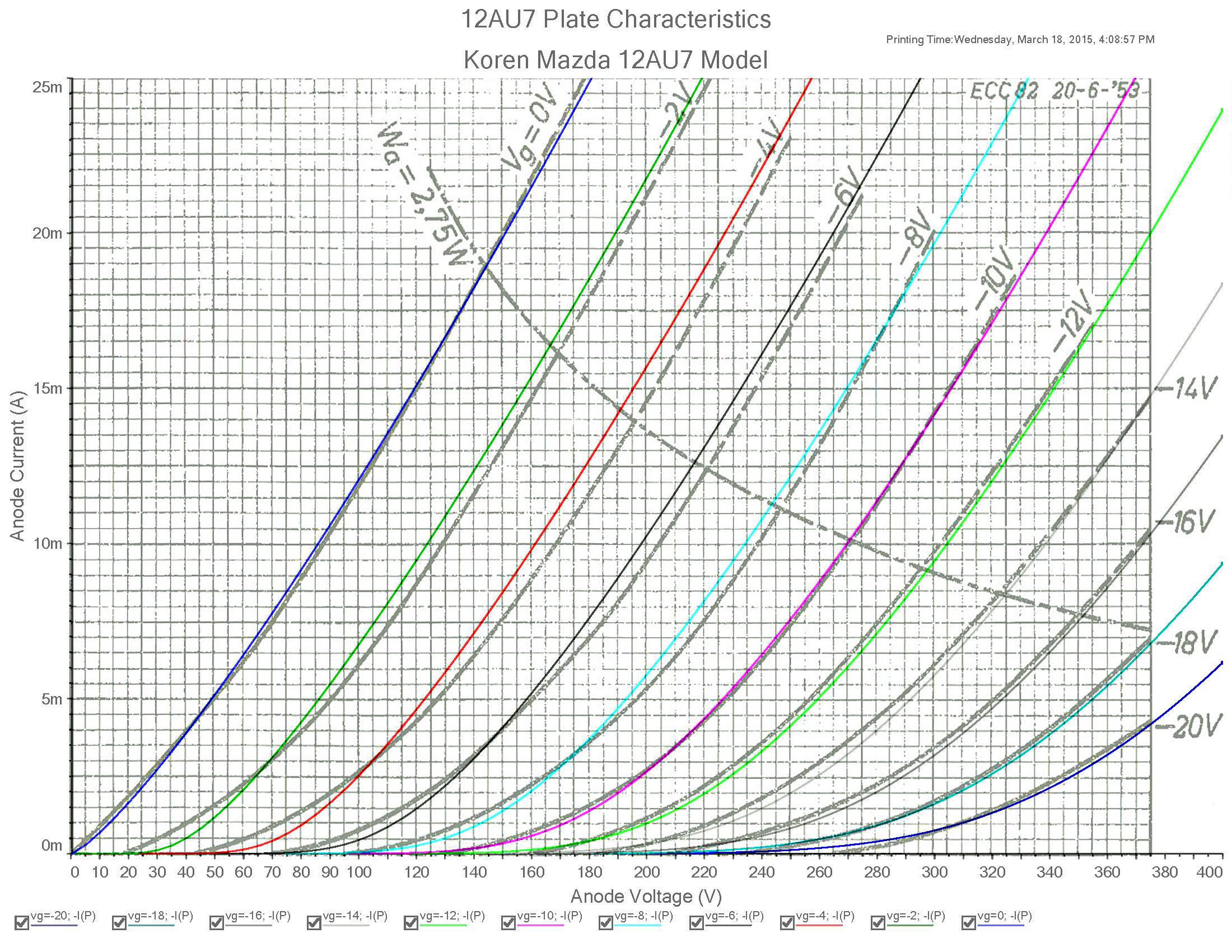

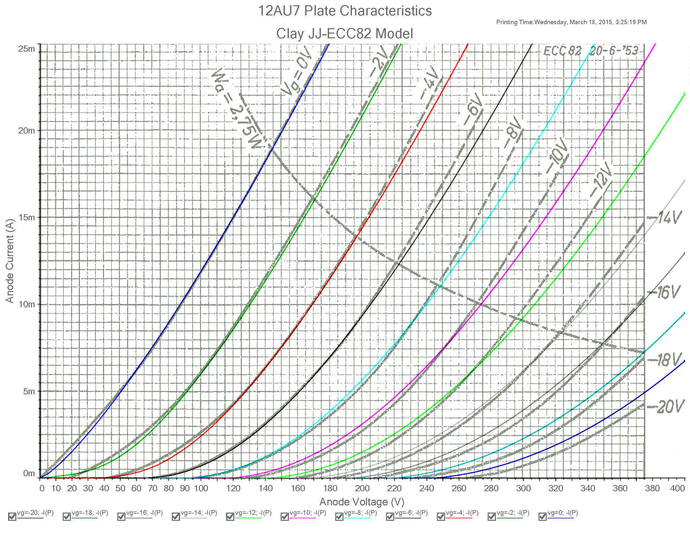

Thanks for all the models! Here’s how yours (and several others’) compare to the Philips ECC82 data sheet (http://www.drtube.com/datasheets/ecc82-philips1954.pdf). Your Mazda is almost as close as Ayumi’s. I used the 3F4 version – would you expect there to be any differences with the others? 😀
Here's a few more triode models:

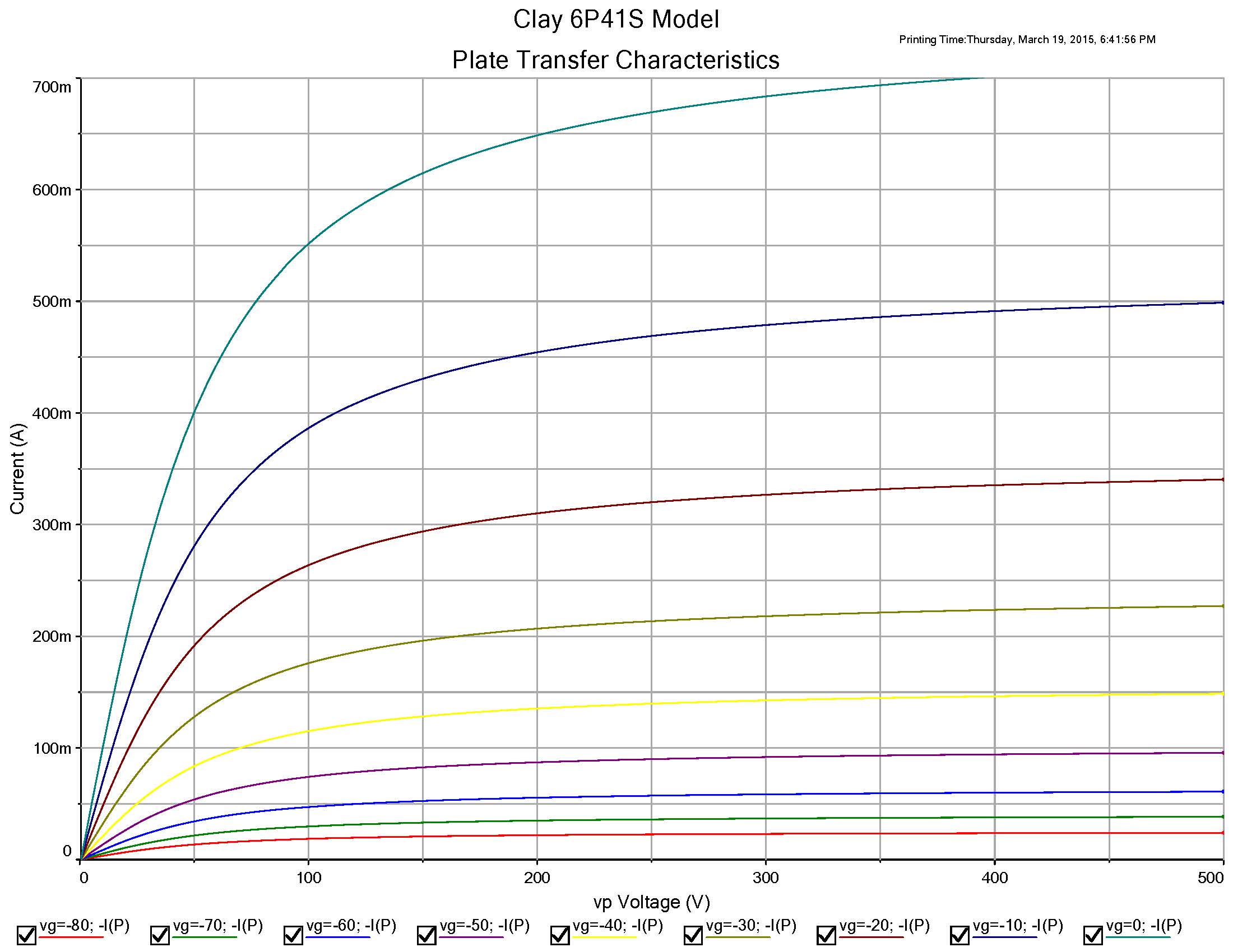

I have not managed to find a working tube model for soviet 6P41S yet.

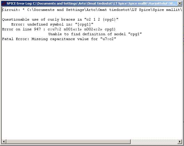

But it gives an error:
The parameters "AX=0.256 Vg_step=1.0" are on a new line, needs to be commented out as there are no corresponding 'nodes' in the subckt. Probably just a word wrap problem. 😉 Also the nodes were not in the correct order for the tetrode symbol in LTspiceI have not managed to find a working tube model for soviet 6P41S yet.

I tested that and got the following errors:
Sorry that was my fault, I should have tested in LTspice before posting. 😱
The node names in the params line must match the nodes in the subckt.

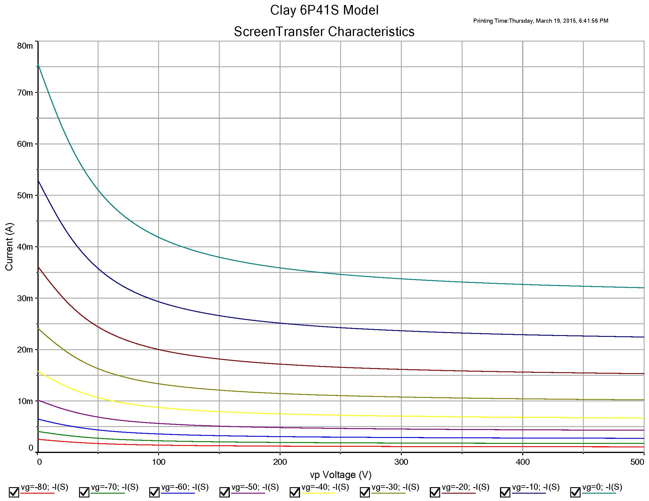

kees,
I’ve attached two Multisim circuits for doing DC Sweep analyses with cogsncogs’ models from this forum. One is his 3F4 Mazda 12AU7 (Dual Triode) Model and the other is his 6P41S (Pentode) model (I modified that one by replacing LOG with LN to keep Multisim from whining). Note that it doesn’t seem to draw any screen current though!
Depending on the version of Multisim 13 you have, you should be able to right click on the tube in the each circuit and “Save component to database” of your choosing. I’d recommend using these triode and pentode models rather than the ones in Multisim’s Master Database because Multisim’s model-symbol pin mapping is different from everyone else’s.
I’ve also attached details of the procedure that I use to generate new models. Please let me know how it works and/or what corrections it needs.😉

I did this really quickly, seems to be fairly close for screen current and I can't read Cyrillic very well... 😀

Got screen! 😀
