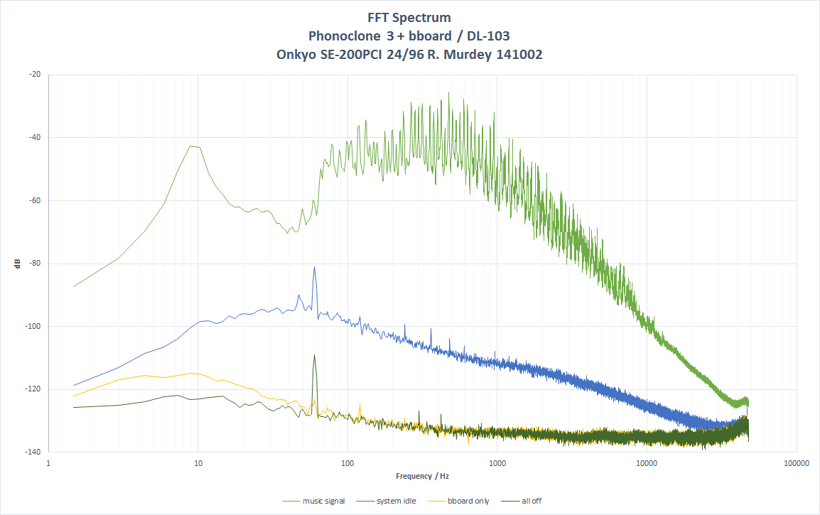

Phonoclone noise measurements
Posted 3rd October 2014 at 12:40 AM by rjm (RJM Audio Blog)
Updated 3rd October 2014 at 09:27 AM by rjm
What we are looking at here is the Fast Fourrier Transform (FFT) of the line output from my b-board buffer recorded at 24 bit, 96 kHz by an Onkyo SE-200PCI sound card. Upstream from the b-board is the Phonoclone 3 MC phono stage, connected to a Denon DL-103. The tonearm is Denon DA-307, and the deck is a Denon DP-2000.
Four recordings, taken 1) with music playing, 2) with the tonearm raised 3) with the phonoclone powered off and 4) with the b-board and all upstream components powered off.
True 24/96 data was obtained, measurements out to 48 kHz are possible, with -130 dB noise floor. (I was using Digionsound 6 to do the recording as Audacity truncates 24 bit recordings to 16 bit in Windows due to licensing issues. The FFT was generated in Audacity however.)
The soundcard's line input may have an impressive-looking low noise floor, but it's still useless for measuring line level audio devices like the b-board because the noise of the preamp/ADC...

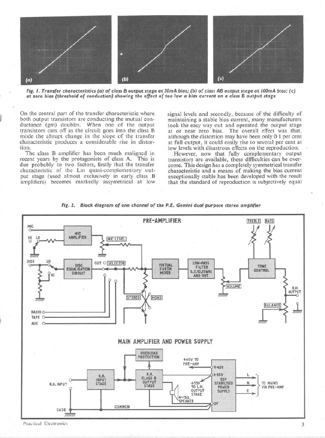

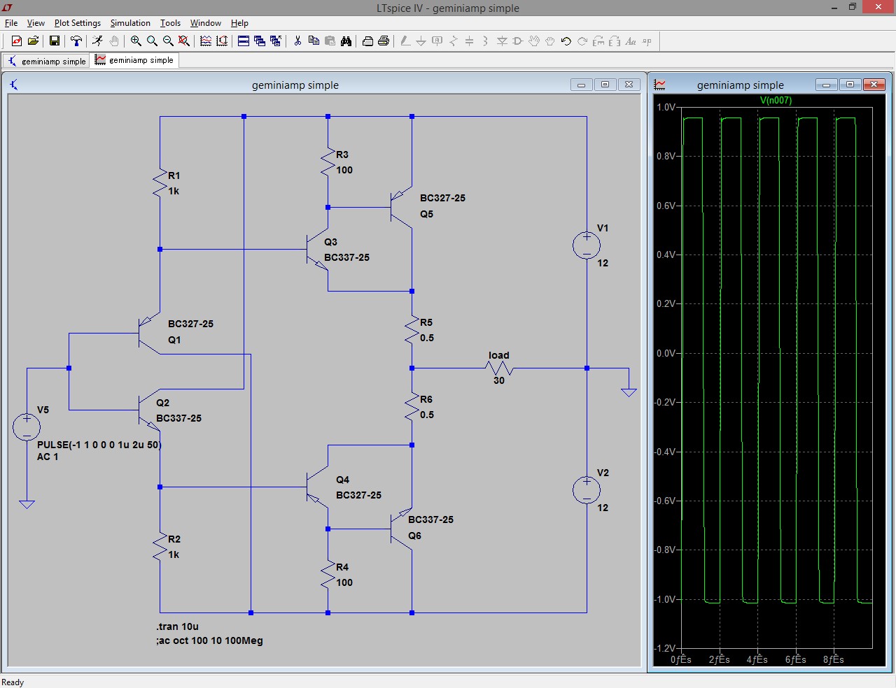

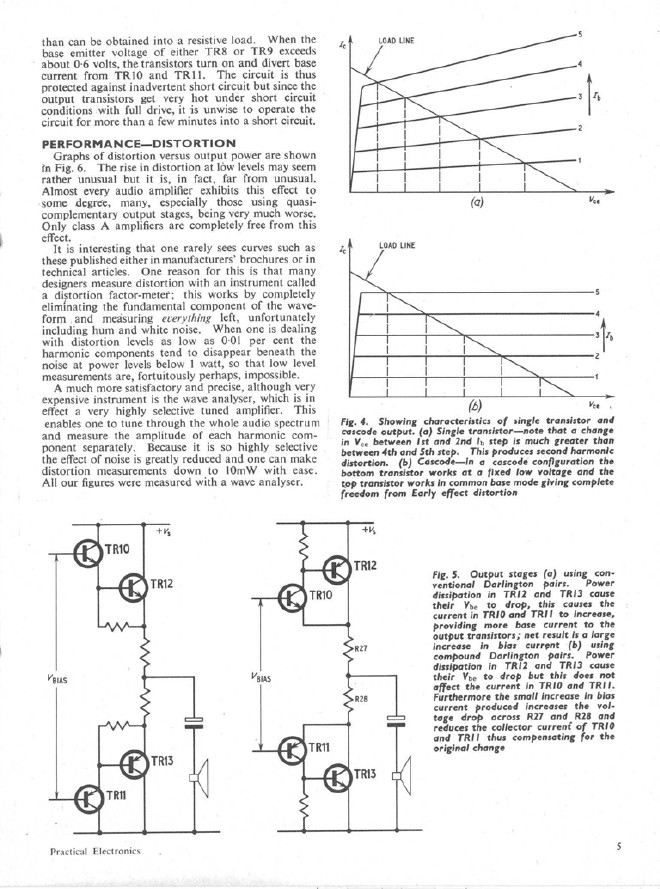

Gemini Amp - and an idea for yet another headphone amp output stage
Posted 25th April 2014 at 10:13 PM by rjm (RJM Audio Blog)
Updated 26th April 2014 at 07:19 AM by rjm
As a companion post to the GeminiPS I thought I'd throw the amplifier circuit out there too...
It's not something you'd have any reason to built today I think, but some of the ideas are worth revisiting.
The output stage is what is normally referred to as a complimentary Sziklai pair. The LTSpice circuit below uses the same output, but with the diamond buffer type bias, with it all scaled down to headphone-amplifier voltages and loads. It would be interesting to compare it against i.e. the conventional diamond buffer used in the Sapphire headphone amp. Maybe I'll get around to it. The simulation shows a bit more transient peaking than the straight diamond buffer, ideally there could be some way of adding compensation / reducing the bandwidth to more reasonable levels.

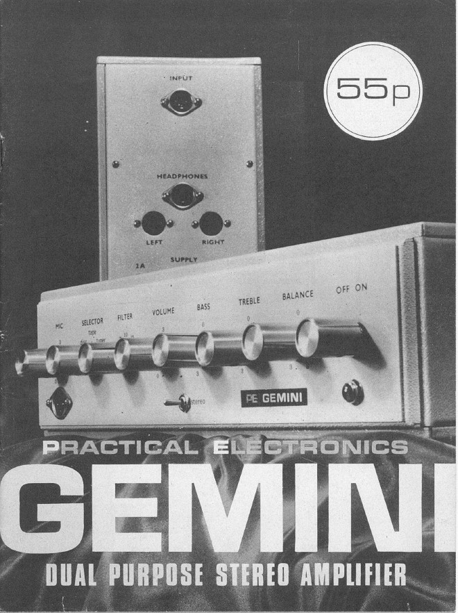

Voltage regulators for (line level?) audio: The GeminiPS
Posted 22nd April 2014 at 01:40 AM by rjm (RJM Audio Blog)
Updated 23rd April 2014 at 11:40 PM by rjm
Part of a series.
The GeminiPS is another discrete series voltage regulator, with a Zener reference and bipolar pass transistor. It's an old circuit, published in Practical Electronics in 1970-71, and written by D.S. Gibbs and I.M. Shaw. I happen to have a reprint, but there's a nice overview here.
For reference it might be worth checking back to the two transistor regulator. The GeminiPS circuit is related in the sense that it is a more sophisticated take on the same basic principle. With just a handful of components we have a stabilized, 30 W output with soft turn on and short circuit protection. The circuit can be scaled up and down relatively easily, and the complimentary (negative output) version is an easy modification.
The pass transistor (TR2/3, Q2/3) is between the circuit common and the rectifier anodes. This may seem odd, but it was relatively common back in the day when high voltage transistors were both expensive and rare. The...
