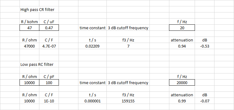

RC filter coupling capacitor calculator
Posted 16th July 2016 at 12:54 AM by rjm (RJM Audio Blog)
Updated 16th July 2016 at 01:10 AM by rjm
When I need to pick the right capacitor for a coupling capacitor, rather than working out the time constant or 3dB cutoff I just remember the mnemonic "0.1-220" (meaning 0.1 uF and 220 kohms) and adjust the ratio up/down for the resistance I happen to be looking at: 0.22-100, 1-22, 0.47-47.
This amounts to a time constant (t=RC) of 20 ms, and 3 dB cutoff of 7 Hz. The bass attenuation at 20 Hz is half a dB.
If there are several stages the attenuation of all these filters add up, so it can be a good idea to make the capacitance about twice as large. There is rarely any advantage making it much larger still.
Excel worksheet attached. It spits out all the numbers so you don't have to guess.
* calculating the attenuation involves complex numbers. Zr=R, Zc=-i/(2 pi f RC), attenuation (high pass) = | Zr / (Zr+Zc) |. In excel you can use IMSUM, IMDIV, and IMABS to do the complex math.

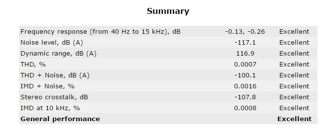

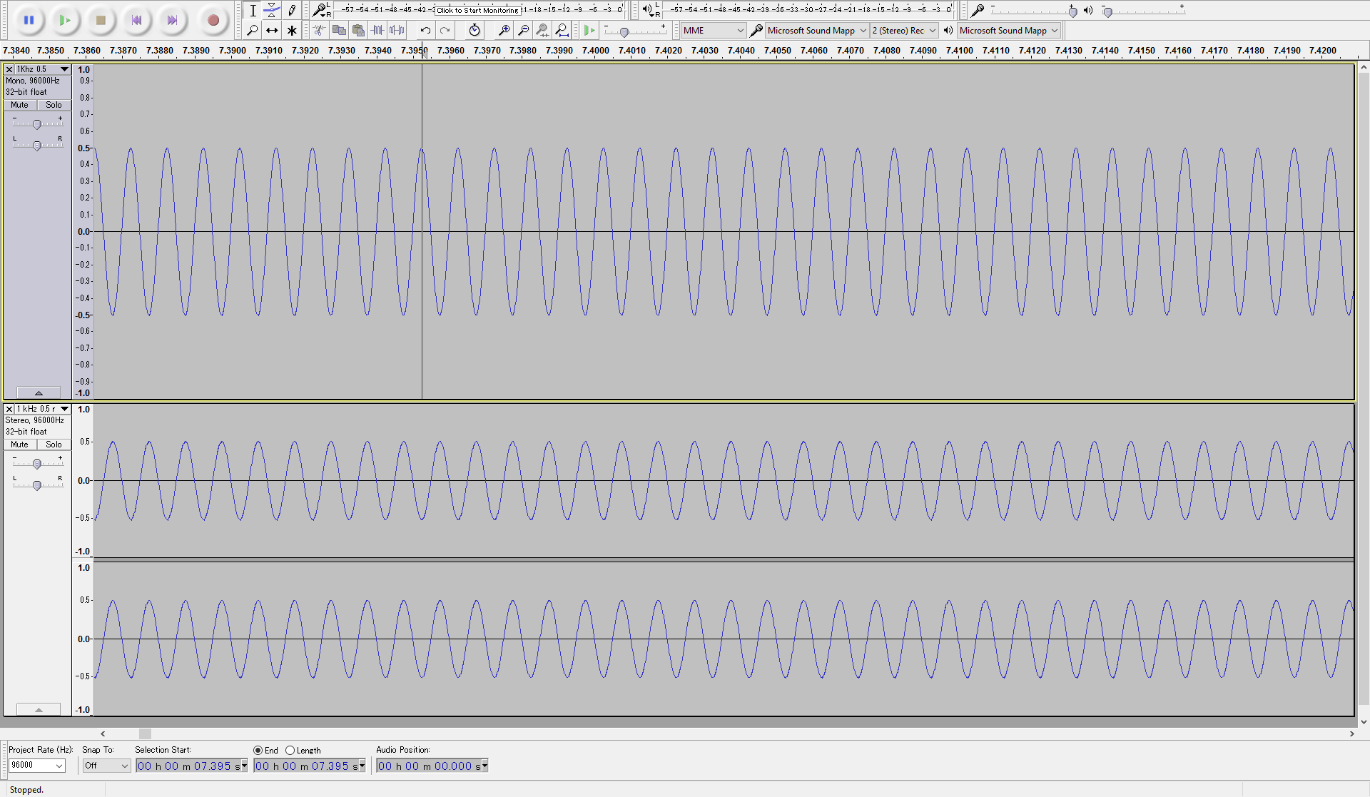

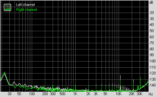

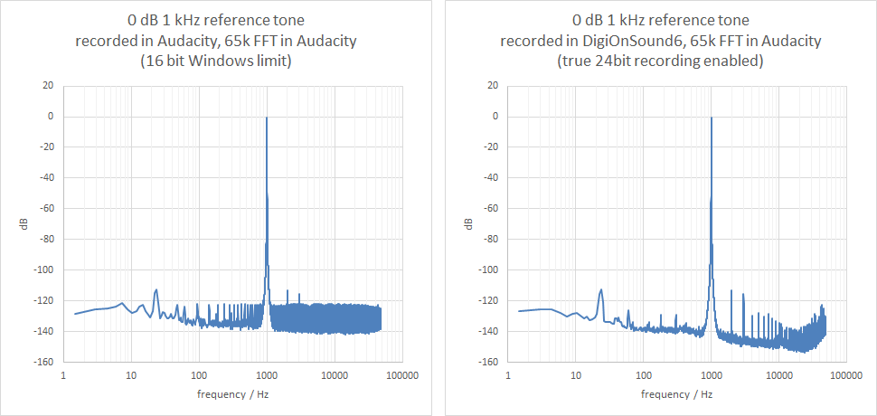

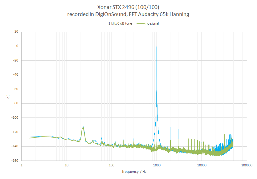

INs and OUTs of the Asus Xonar Essence STX PCIe computer sound card
Posted 26th June 2016 at 08:12 AM by rjm (RJM Audio Blog)
Updated 18th July 2016 at 03:42 AM by rjm
Asus Xonar Essence STX, Audacity 2.1.2, VLC, Windows 10 [and DigiOnSound6 Express for 24 bit recording]
Purpose
To confirm the calibration of the sound card input and output gain. Also, to determine the relationship between the signal voltage, the recorded signal amplitude displayed in Audacity, and the signal peak and noise baseline levels in the FFT spectra.
Summary
* Setting the volume slider of the device output to 100 gives 1 V rms output for an amplitude 0.5 sine wave.
* Setting the volume slider of the device recording line input to 100 gives records a 1 V rms tone as an amplitude 0.5 sine wave, which is displayed in the frequency spectrum (FFT) as peak of magnitude 0 dB in Audacity when both channels are averaged.
* volume setting 100 needed for unity gain loopback.
* 0.5 amplitude sine wave = 0 dB FFT = 1 V rms.
* noise baseline in averaged stereo FFT is 3 dB lower than single channel measurement....
