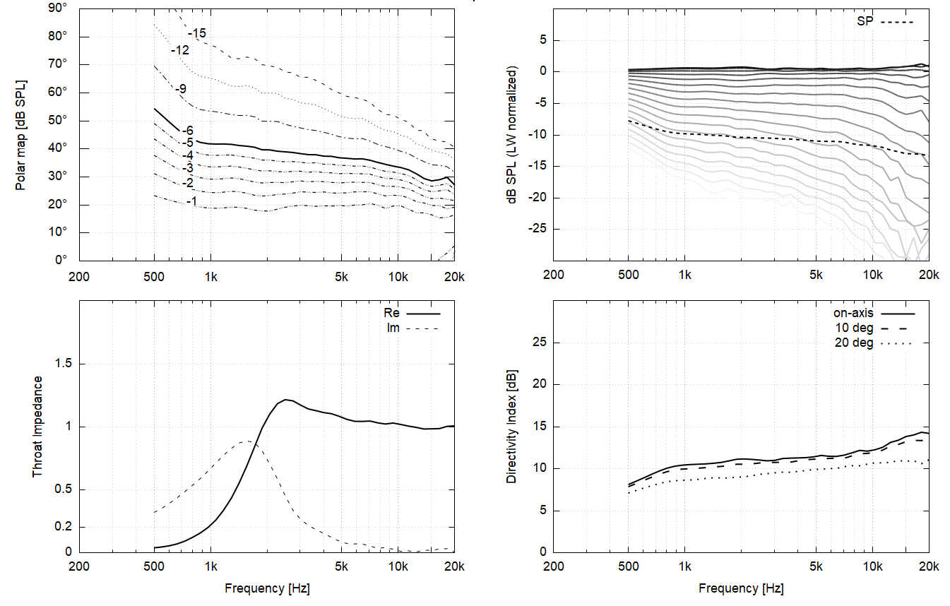

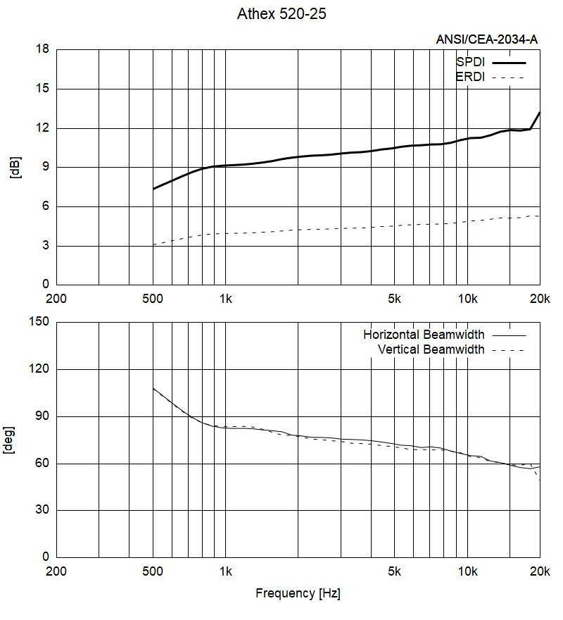

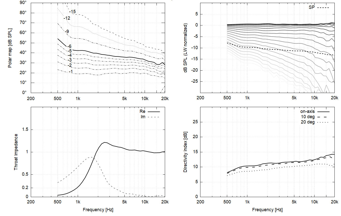

As for the Athex horns, I should point out that the 520-25 was actually designed for a 1.4" driver (Faital HF146 or similar) that has a 1" phase plug exit, i.e. to be used with an internal ring plug. For regular 1" drivers this waveguide is probably needlessly big.
