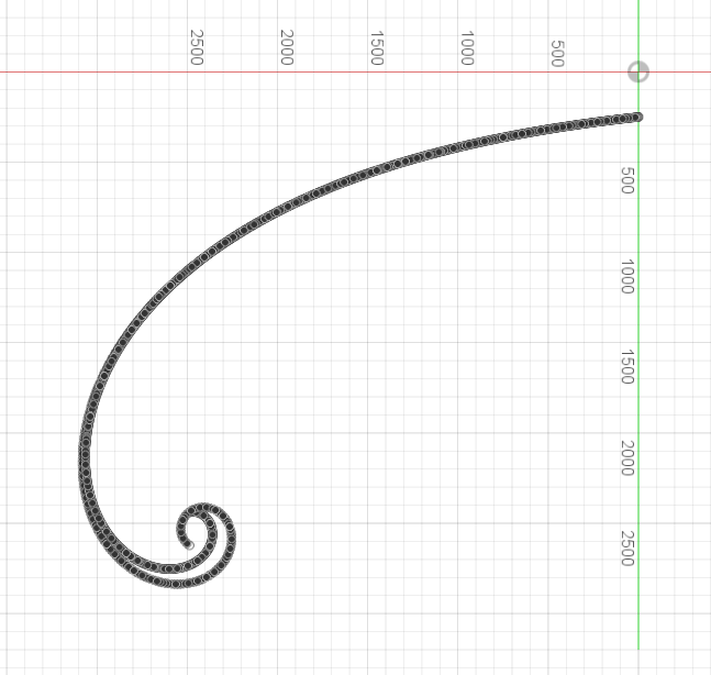

I do but scattered around in different files. I'll see if I can share them.Do you still have the coordinates of the profile, BTW? I would love to try it.
That wouldn't be the main problem with beaming sources (I don't move a lot during listening either). The bigger problem is that with a beaming source the early reflections contain only very little high-frequency energy. Don't ask me why but this just doesn't sound as natural as when these reflections are spectrally more similar to the direct sound. There's nothing you can do about this in the room - to regain balance you would have to absorb lower frequencies but not the higher ones - a tough task to do.But mind you they are not that beamy, such that you need a vise to keep your head centered, but obviously the center place is the best.
That would be great!I do but scattered around in different files. I'll see if I can share them.

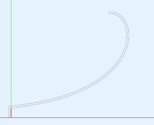

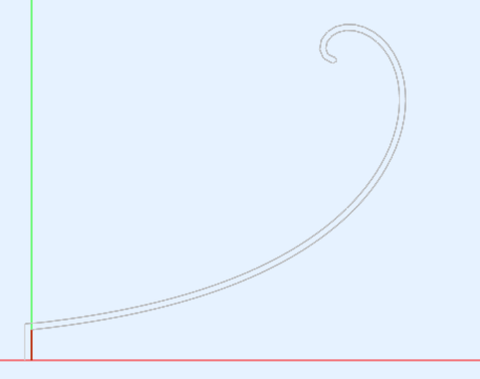

Thank you for the offer, very nice! The absence of first reflections does not bother me. Well, I did use a biradial tractrix horn before, but in the end I ditched it because of the pattern flip, the round/petal horn I now listen to sounds more natural to me. I am able to create horn profiles myself -but again thanks for your involvement.If you want to try them out I could help with then profiles.

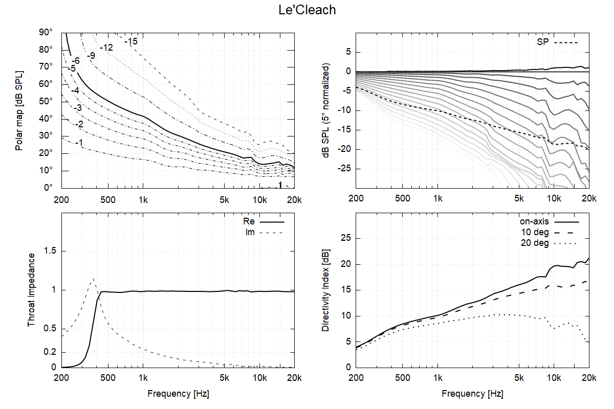

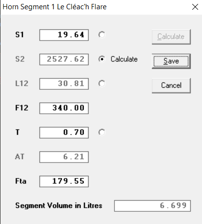

What cut off frequency, T, throat diameter and exit angle of compression diver?I'm interested in an axisymmetric one.

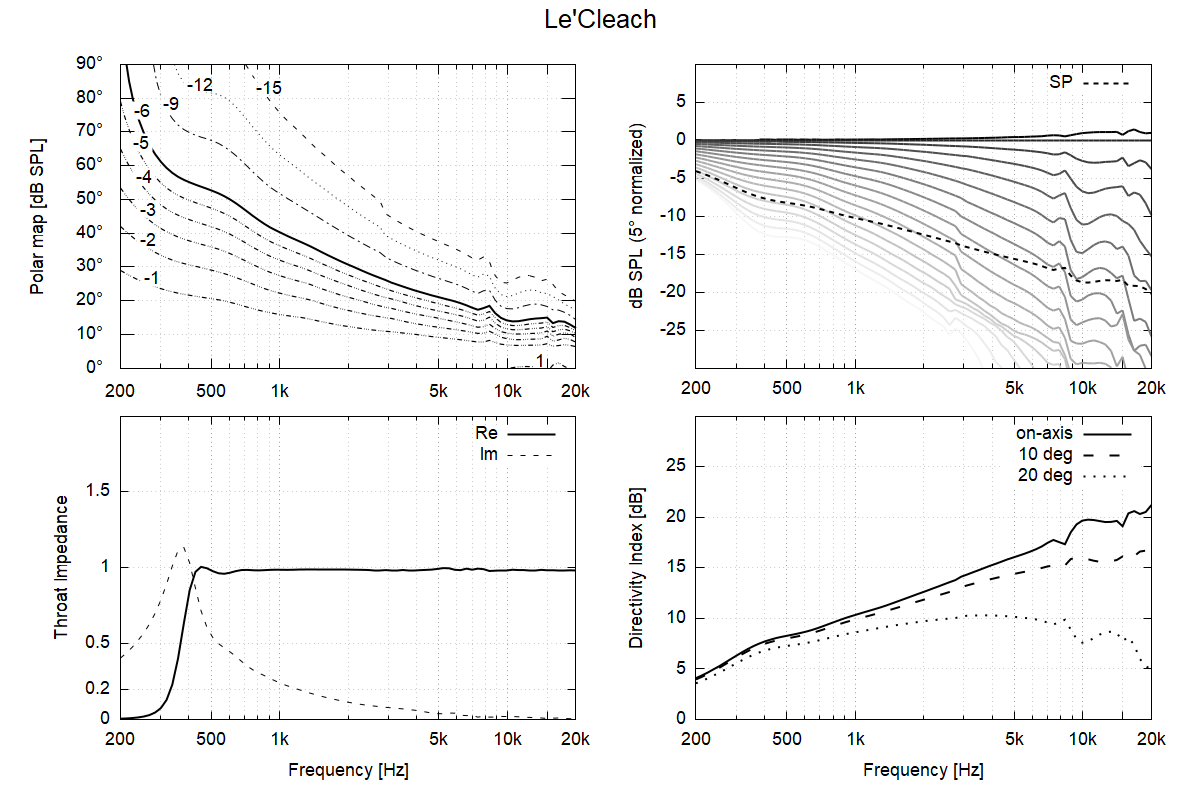

Hornresp gives an exact solution which is slightly different in the mouth when compared with the older spreadsheets , the "canonical" use for a horn like this has been T=0.7 and using it above around 2x cut off. I attach a comparison between the spreadsheet and Hornresp (units not correct) for a 340Hz/T=0.7 horn with a 2 inch mouth and the exported horn geometry profile from Hornresp.
I used the spreadsheet from Le'Cleach, looks slightly different indeed. If it matters, don't know.Hornresp gives an exact solution which is slightly different in the mouth when compared with the older spreadsheets

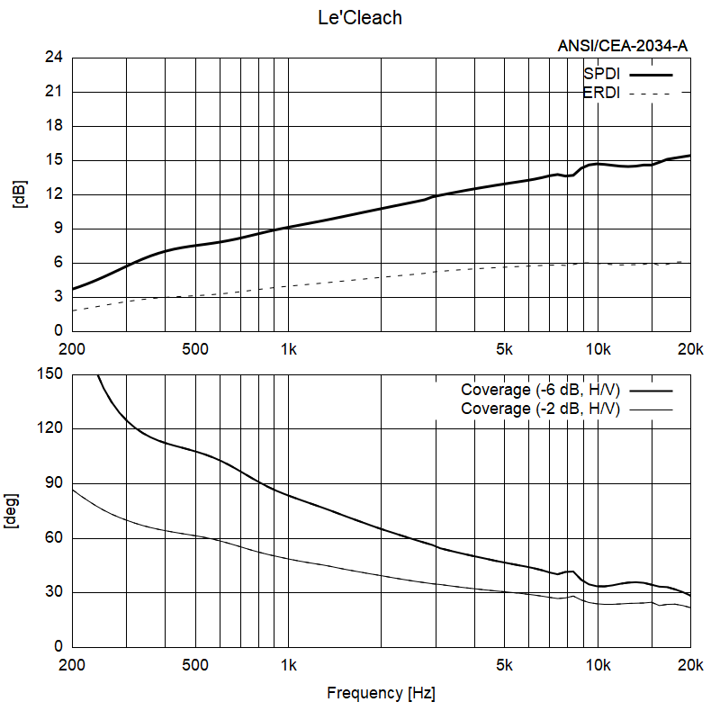

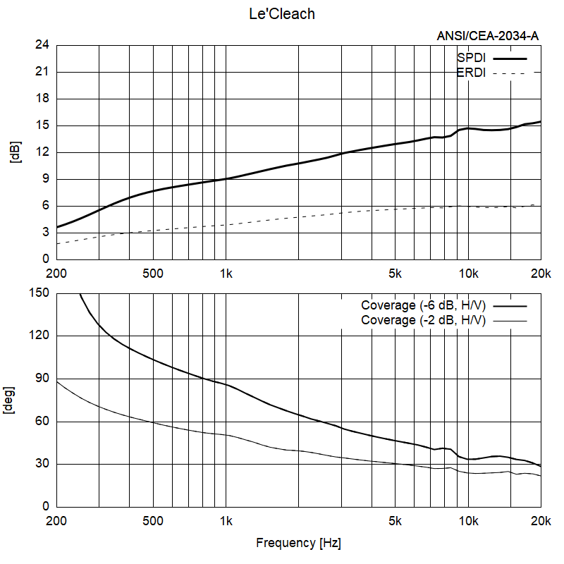

Thanks! I quickly put it into Ath&ABEC. Overall, no surprises -
I like the impedance, hate the beaming.
(It could probably be approximated by a R-OSSE profile quite well, I may try that some day. I'm sure several very similar horns have been shown in this thread already - perhaps something like this: https://www.diyaudio.com/community/...-design-the-easy-way-ath4.338806/post-7337185, which probably wouldn't suffer as much from the "group delay issues" around cut-off, so often mentioned.)

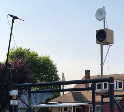

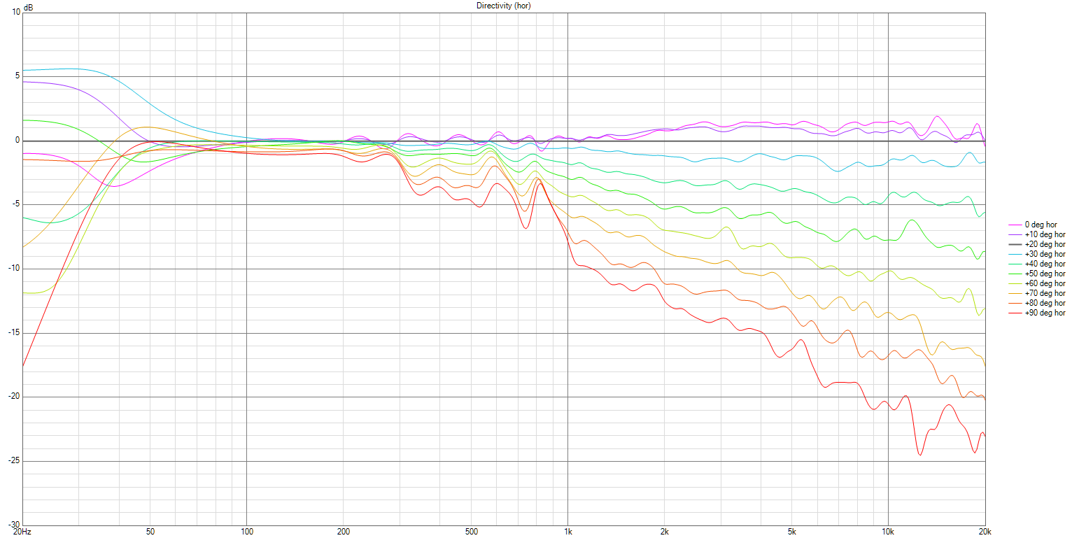

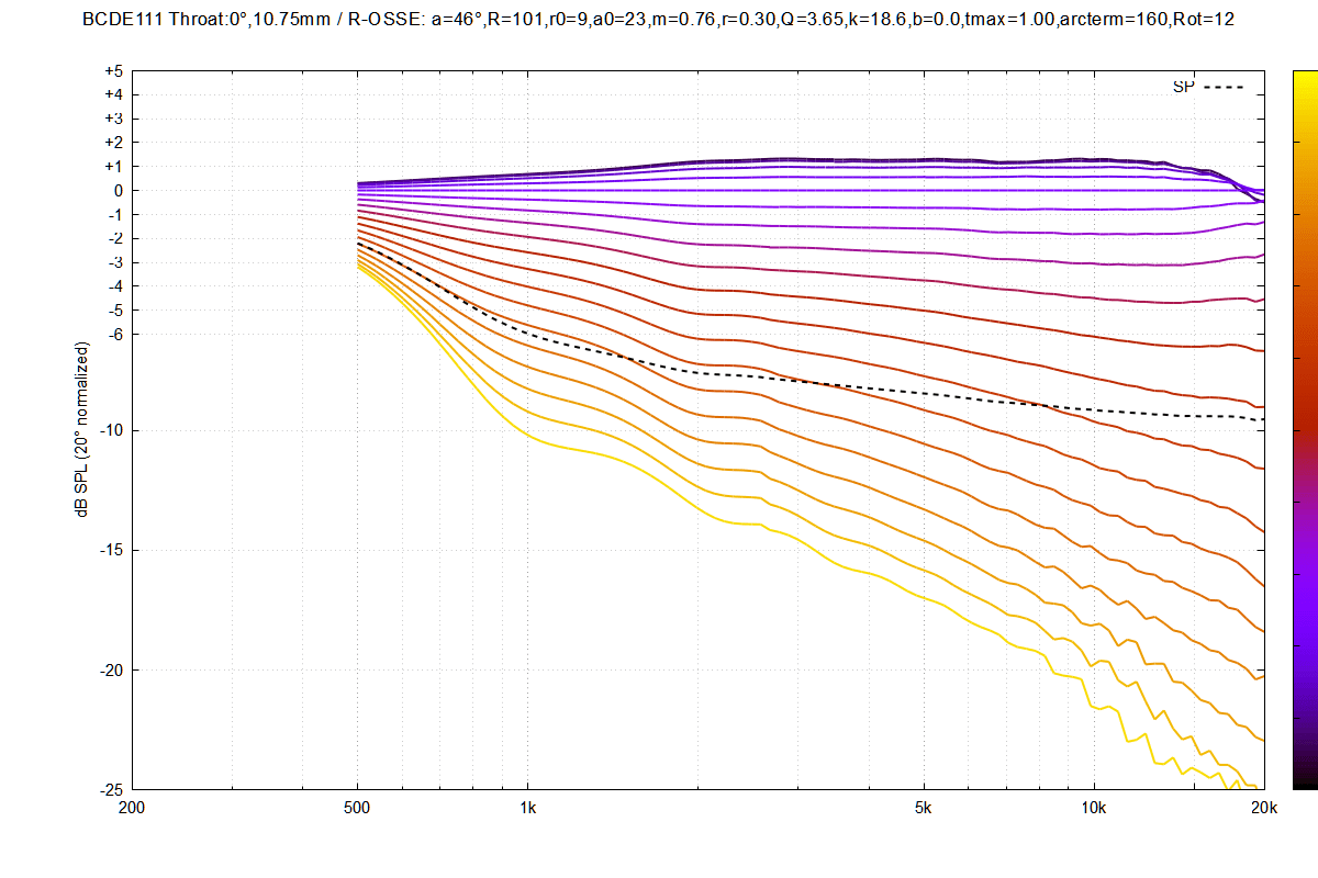

Freestanding 46 degree B&C DE111 R-OSSE over an 8 inch Dayton DC200-8 in a 9x9 inch enclosure. Waveguide can be moved up and down to find the best center-to-center distance relative to crossover.

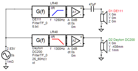

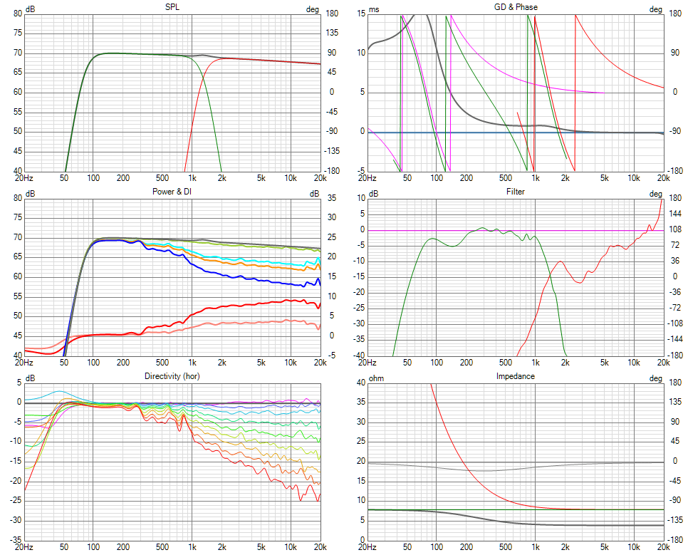

I don't know how to make crossovers. I'm learning in VituixCAD. I create the crossover then export it to Equalizer APO. That allows me to hear the crossover changes immediately. I'm listening to high order crossovers to get a feel for it then I'll back off to lower order crossovers more suitable for passive designs.
As expected, waveguide performance matches the simulations.
I've listened to stereo music and watched a movie using only one speaker as a center channel. Music is very good but I'm most impressed with how well it works as a center channel for dialog intelligibility.
![Practice var3 XO-schema-3.png Practice var3 XO-schema-3.png](https://www.diyaudio.com/community/data/attachments/1099/1099129-6323ef5d9271d54f882d059438299a9a.jpg)
![Practice var3 Six-pack.png Practice var3 Six-pack.png](https://www.diyaudio.com/community/data/attachments/1099/1099130-67ba945d5ef7ed55000f9c6273202b2c.jpg)
![Practice var3 Directivity (hor).png Practice var3 Directivity (hor).png](https://www.diyaudio.com/community/data/attachments/1099/1099131-cd63e218311c4a4d7b86190aab60890d.jpg)
![46_8inch_DE111_normalized_20.png 46_8inch_DE111_normalized_20.png](https://www.diyaudio.com/community/data/attachments/1099/1099132-9aab78ffceb5541f81a7db376320989c.jpg)

Crossover is anything that leads to a desired acoustic result without burning anythingI don't know how to make crossovers. [...]
It's amazing to see it working so nicely. Now give yourself time to listen and adjust - you can still make it anything from great to unlistenable just by small tweaks in the crossover.
