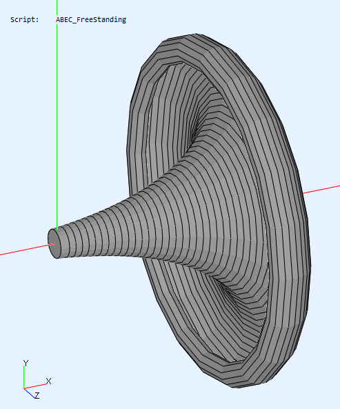

I'll need to order more 3D filament. I burned through all of mine making variants of just this one waveguide for the two compression drivers (DE250, DE111) and how they fit to match internal rings. As you mentioned in a previous post, part of 3D printing is learning how to construct a model that will successfully print on your 3D printer without warping, fitting together nicely and easily, etc.
(If anyone wants the 3D models I've made I'm happy to post or send them via direct message. Just don't rely on them 100% because I think they could be made more precise in the conical throat section of the drivers. But if you want a basic starting point they are good enough for that.)

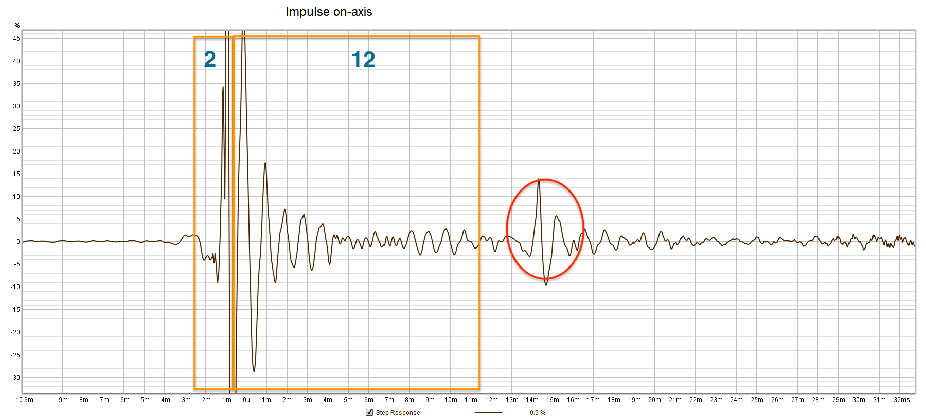

Inexperience. I thought the big squiggle was the one we are supposed to gate out.

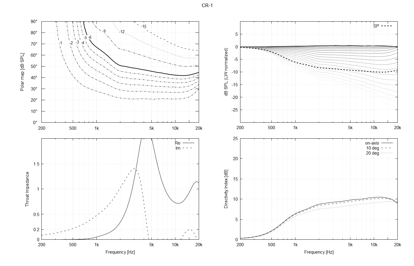

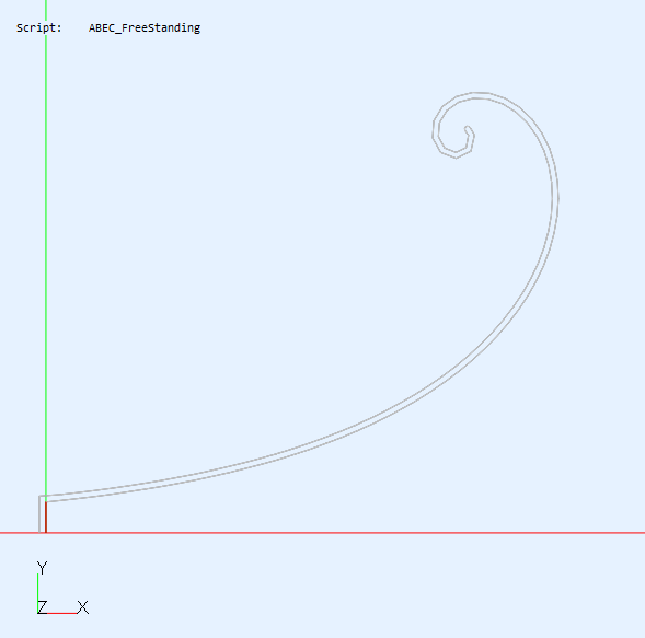

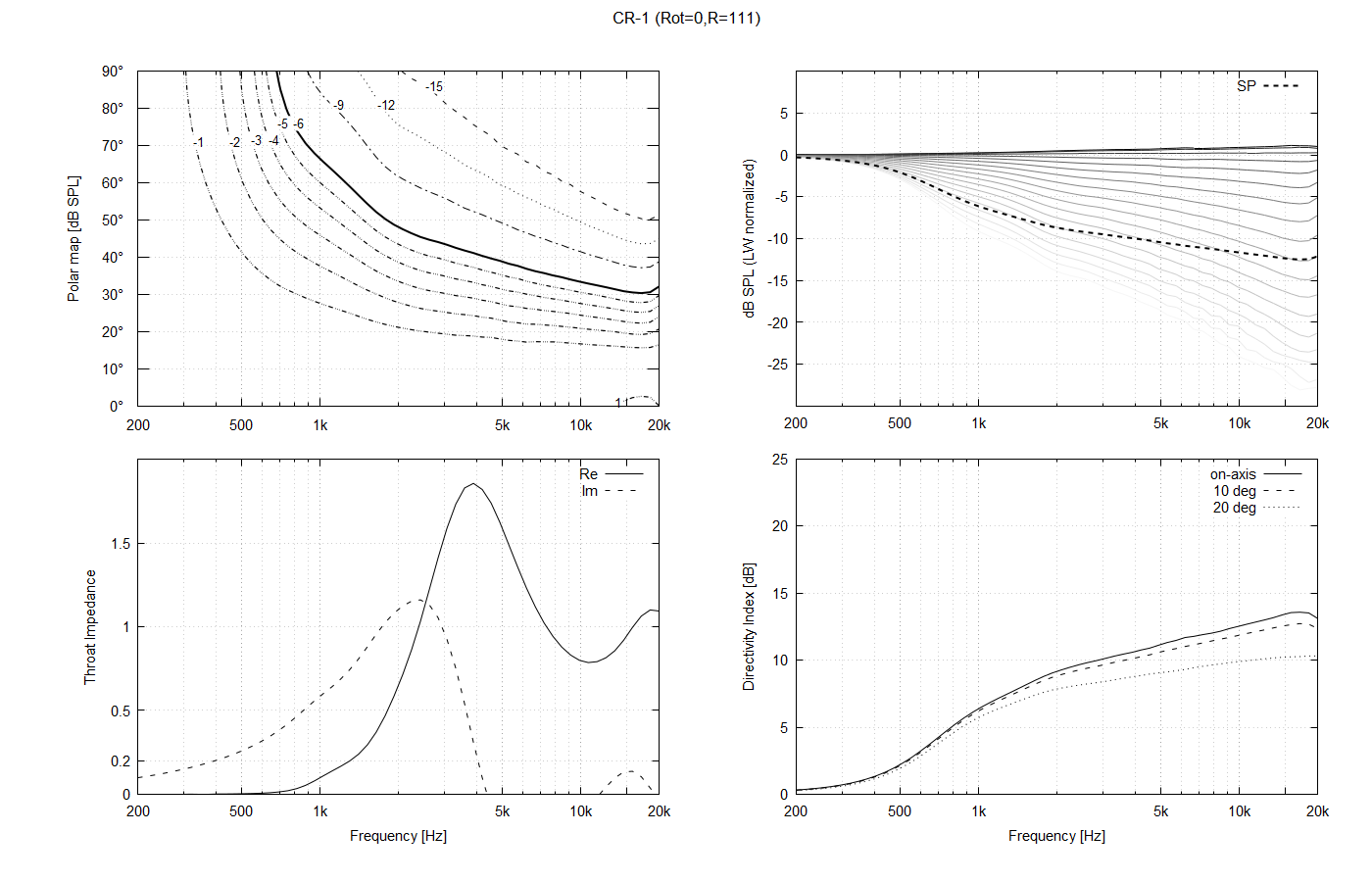

Here is the config file for the DE111 R-OSSE. I started modifying it but then decided it would be better to let you guys do it because you have a better understanding of how it will interact with the 8 inch driver enclosure/crossover. I'll print the version you think would make a good test and do my best to give you feedback.
Throat.Ext.Angle = 0
Throat.Ext.Length = 10.75
Slot.Length = 0
R-OSSE = {
R = 101 ;
a = 46 ;
r0 = 9 ;
a0 = 23 ;
m = 0.76 ;
r = 0.30 ;
q = 3.65 ;
k = 18.6 ;
b = 0.0 ;
arcterm = 160 ;
Rot = 12 ;
<3

It does sound dull at first. I created a playlist of songs Sean Olive (Harman) uses to evaluate speakers in Amazon Music and listened through it with the crossover variants. Over time I drifted toward R7. Maybe I'll drift back toward a flatter on-axis (less dull) variant as I continue listening. After listening and adapting to R7 I wouldn't call it dull anymore.

My memory is terrible but I think the way I got to those numbers is I saw you say something about a Rot=3 in conjunction with a different config setting widened the directivity in the higher frequencies. That made me curious about Rot so I over-exaggerated Rot to see what would happen. I distinctly did not care about optimizing for higher frequencies because I can't hear them. My hearing is non-existent above 12kHz and that's a stretch to even claim 12kHz. However, the simulations looked good and it was a smaller + easy to print waveguide. Which was great because I wanted to see what freestanding R-OSSE waveguides sound like in real life. They sound as good as the simulations look. Now I'm very interested to read feedback from people who build larger waveguides like the ones you're working on. I know these little waveguides sound beautiful, imagine how good the large ones designed by people with knowledge and experience are going to sound.

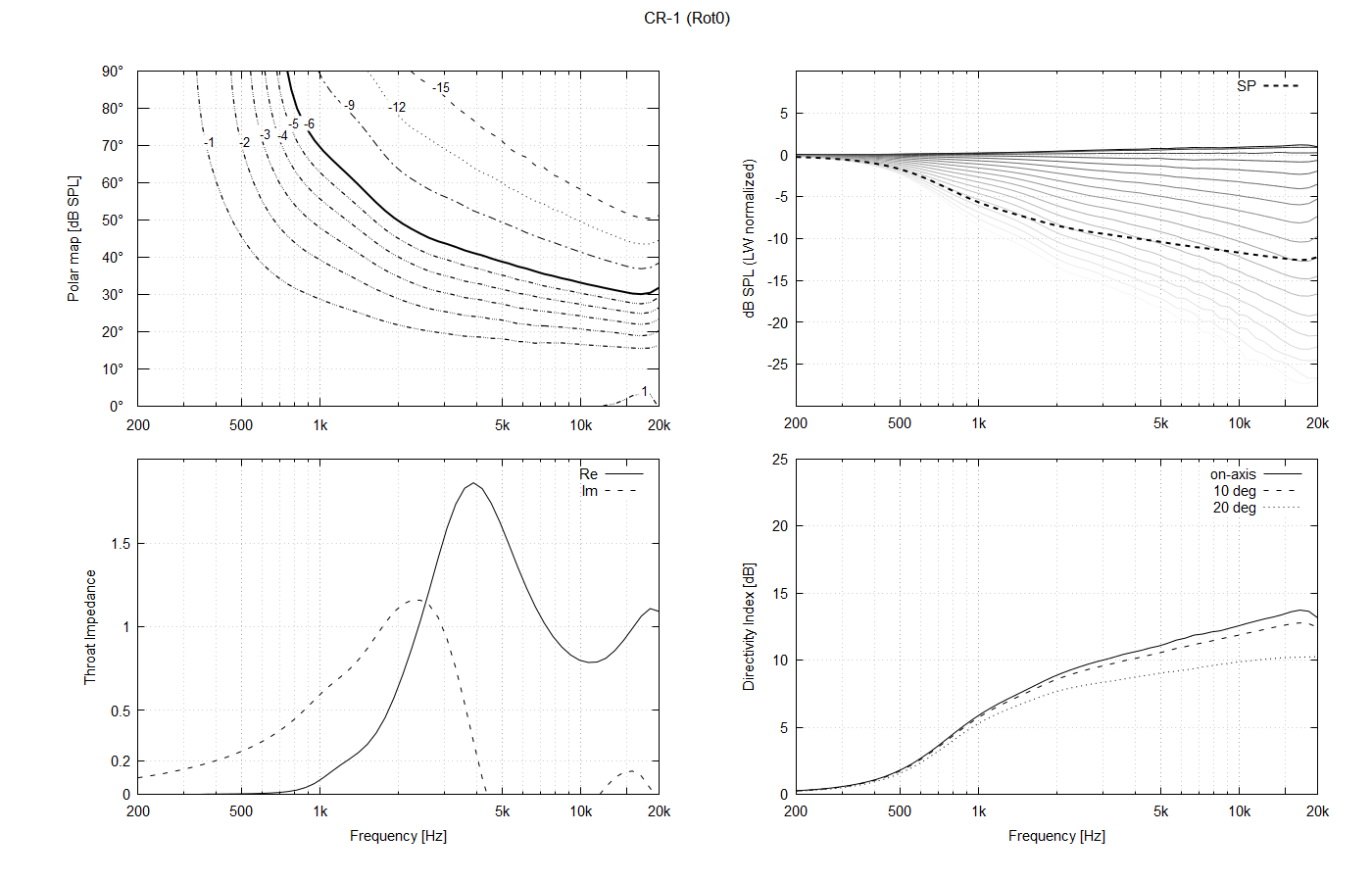

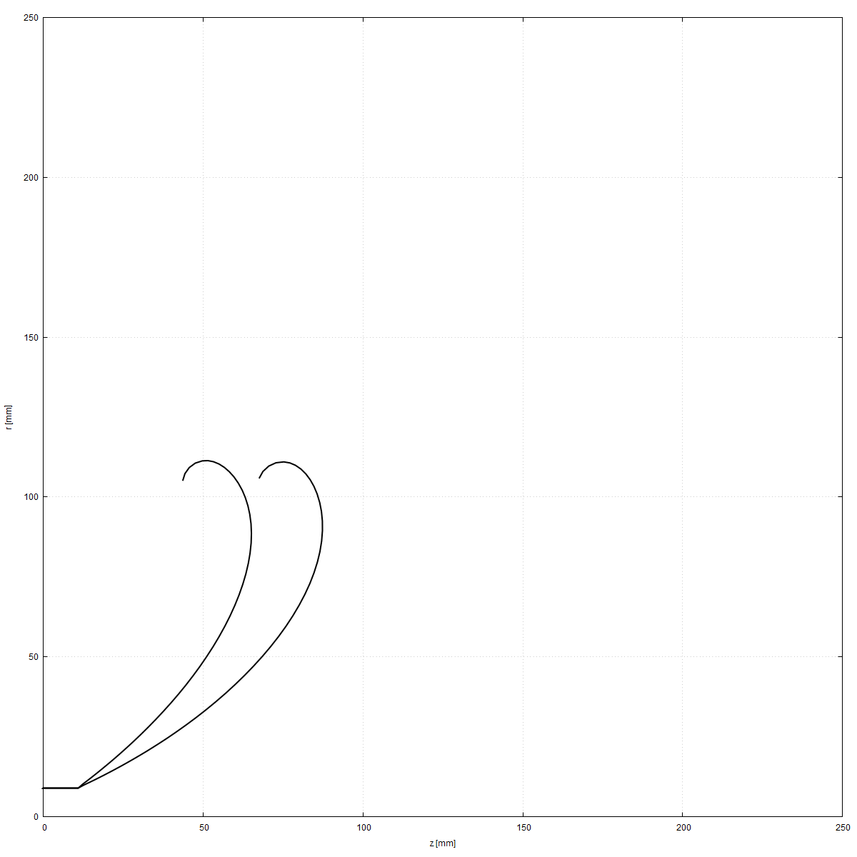

First thing I tried was to decrease 'Rot' and it seems to do what we need. This is for your settings (left) and for Rot=0 (right):Here is the config file for the DE111 R-OSSE. [...]
The on-axis DI is higher roughly by 3 dB at 10 kHz, which is what is takes to make the on-axis FR more or less flat in your R7 version, while retaining a similar power response.

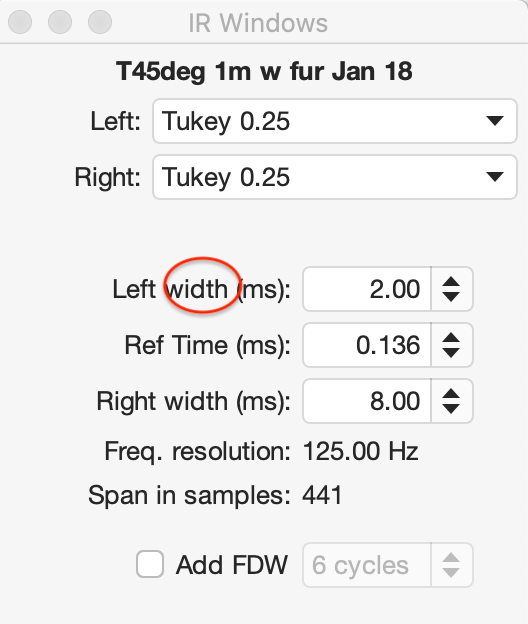

So as I indicated in a previous post I didn't understand the window setting meny correctly so my posted picture where not correct. Now that I'm better informed I think your used window looks like this and you did set it so that the wiggle in the red circle was outside the window, so as too take it out of the measured result. My pitfall was that the windows where sizes (ms) and not time stamps (ms), like the Ref.Inexperience. I thought the big squiggle was the one we are supposed to gate out.
Sorry for the confusion!
I realized afterwards that by removing the rotation, the overall diameter will be of cource smaller (hence the lower DI below 1.5 kHz). It could be actually a better match for your woofer but to assure the rest equal for the experiment, perhaps you might want to set also R=111 mm, which compensates for this. Now the DI makes a gradual rise against the current version.First thing I tried was to decrease 'Rot' and it seems to do what we need. ...
So the proposed change is:
R = 111
Rot = 0

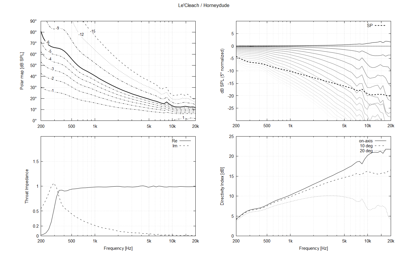

@mabat Attached a csv file for the Le'Cleach horn profile of my horn, feel free to simulate- Do you still have the coordinates of the profile, BTW? I would love to try it.
I dofeel free to simulate![]()

It has been changed since 5.20.14 so perhaps one want to upgrade........ My pitfall was that the windows where sizes (ms) and not time stamps (ms), like the Ref.
