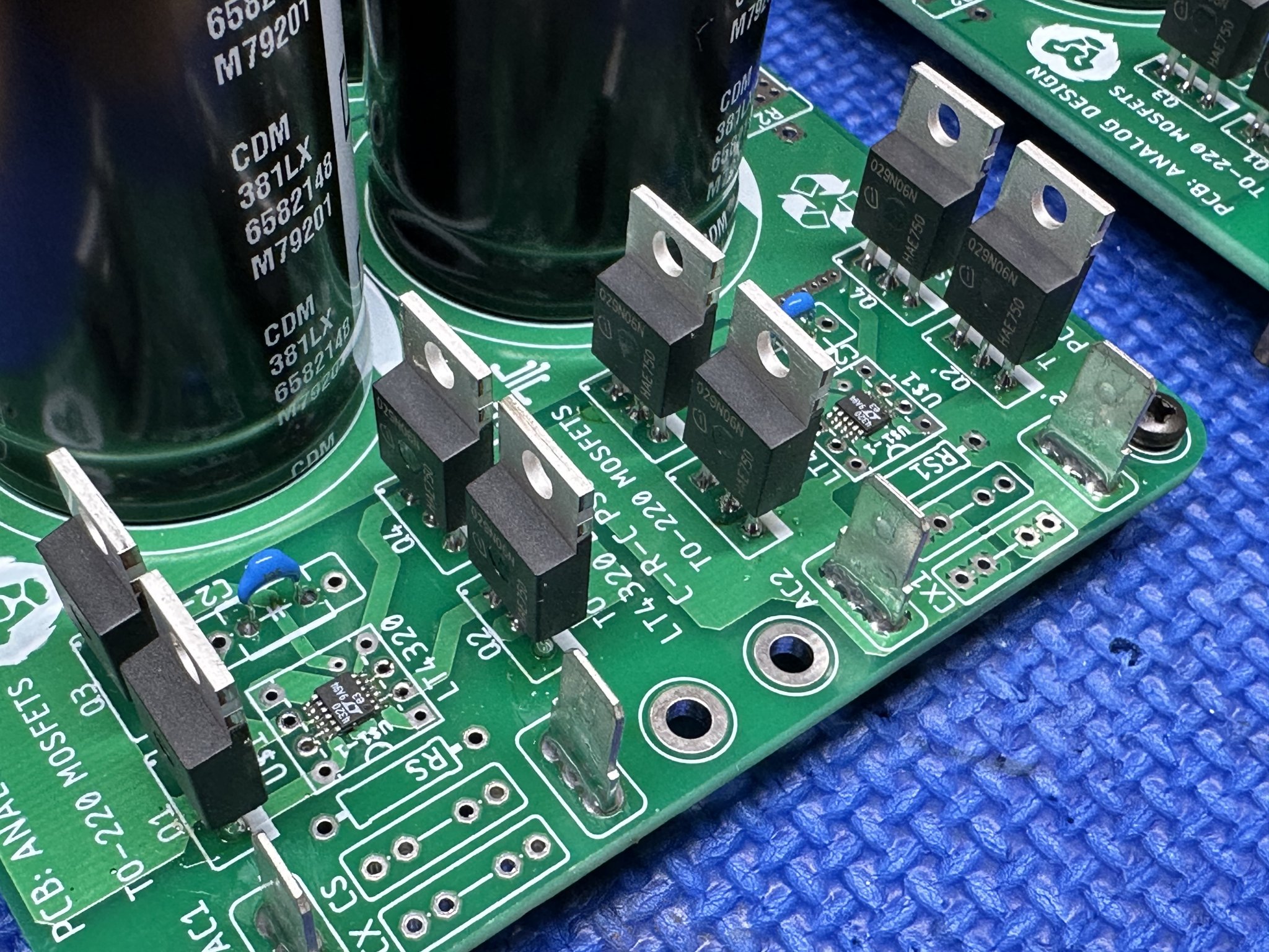

Paste, hotplate from bottom, hot air from top. This method ensures the MSOP12 belly pad is soldered.
Mosfets - IPP029N06N
There was a time when the LT4320 in MSOP12 package was about half the price of the DIP8 version, I stocked up on them. But now the prices are basically equal☹️

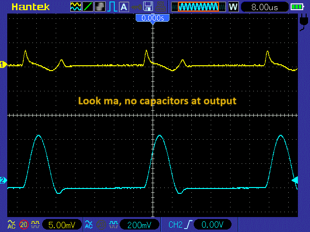

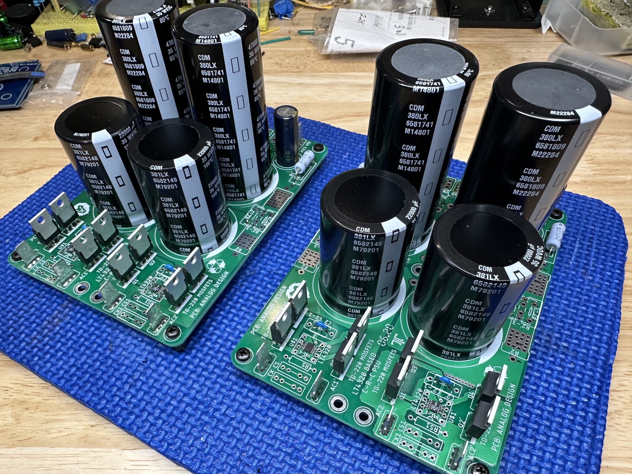

Hey Vunce nice build whats this "R21" modules?Made some power supply progress this weekend, 22mF first cap, 47mF second cap.

I see superb soldering at every PCB position. More than well done.Made some power supply progress this weekend, 22mF first cap, 47mF second cap.
Next step: build “R21” modules.
Big output capacitors are not required with R21 voltage regulators but they don’t hurt either. In fact, they help a little with PSRR at very high frequencies. In my build output capacitors are 10 mF. They are big because of long life (13.000 h) & 63V properties.
I believe you have a Quasimodo jig. Don’t bother with snubbers in case of active rectification. I’ve measured a lot and ringing is practically nonexistent (10 -100 times lower than with diode bridges). Nothing to measure as induced noise at PS output or amplifier circuit.
I can swap the tall caps for another pair of 22mF instead, they are not visually appealing 😂. I plan to add a 120uF motor run PP cap at each ps output rail (4 total).
Cleaning the flux residue will make anyones soldering look better😁.

When amplifier lid is closed, it doesn’t matter but will it ever be closed? Mine still isn’t.I can swap the tall caps for another pair of 22mF instead, they are not visually appealing 😂.
You’ve approached PS build as it will be a standard CRC. With voltage regulators rules are different.
22 mF at output is fine. Another option is to swap capacitor positions and put 47 mF as a first reservoir cap. R21 voltage regulators actually don’t require any capacitance at output for stability and their output impedance is 40 uΩ at 20 kHz. In example, here is R21 output under transient load with no capacitance at output (well, there is likely 100 pF parasitic capacitance). Yellow is regulator output and blue trace is voltage measured at active load 0.085 Ω, so transient load is 5 A peak half sine repeated at 20 kHz rate.
Don’t bother with motor-run capacitors. Amplifier has all the decoupling capacity required and motor-run capacitors will have no effect. Amplifier will provide perfect 100 kHz, +/-15 V square wave response with no ringing or overshot even with simple CRC power supply.

In general, if using two prasi’s CRC boards with active rectifiers, you need two 2 x 12 V to 2 x 13 V, 120 – 150 VA transformers or one 300 VA with 4 secondaries.
With one PS board for both channels, you need 2 x 14 V, 250 – 300 VA transformer. Small overvoltage can be mitigated as explained in post #35.
