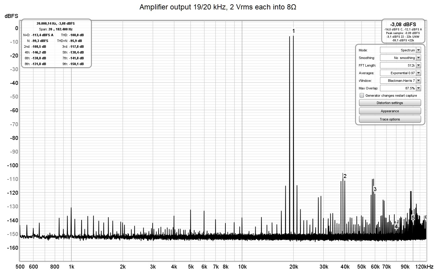

Take a note of my later distortion measurements after discovering REW bug (it’s fixed now). Distortion at 1W is from 0.00007% to 0.00009%, depending on measured channel sample.
At full power and sine wave signal, actual MOSFET gate currents are 4 uA rms. OS is follower so GS voltage has little changes.
Square wave and achieving slew rate limits requires 10 mA peak currents to gates.
Opamp actually never leaves class A operation as required output for full power is 18 uA rms.
Intermodulation distortion is amazingly low. Check post #54 at this thread and this link for more IMD measurements:
https://www.diyaudio.com/community/threads/opa828-opa2828-vs-opa627.400109/post-7484535
Here is a sample measurement where IMD is mostly below -130 dB at 1 W combined output. Measurement contains used DAC IMD as well.

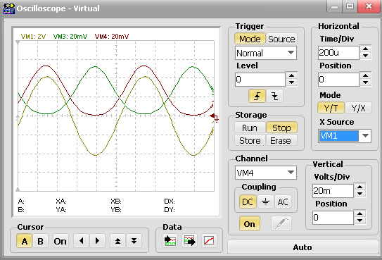

In my case, the latest iteration of an amplifier project has Exicons paired with small signal MOSFETs as compound pairs. Barring any disastrous oscillation that might make it unusable, it reduces HD of the source followers by about 20dB, so that seems promising. What I might do is implement soft clipping for the top 6dB. So for ±10V 'net' that leaves about ±5V for a super clean signal.
The top traces show individual Exicon currents through 0.1 ohm sense resistors, with about 200mA bias. VM1 is 4V out into an 8 ohm simulated speaker load. THD about 2.3E-5%, which is quite impressive considering the strongly visible compression.
That was with a fake battery bias and an NE5534 op-amp driving the lower gate. What's interesting is that if you put something like 1M in series with the battery and a 47n shunt, trimming the voltage somewhat, the distortion doesn't change.

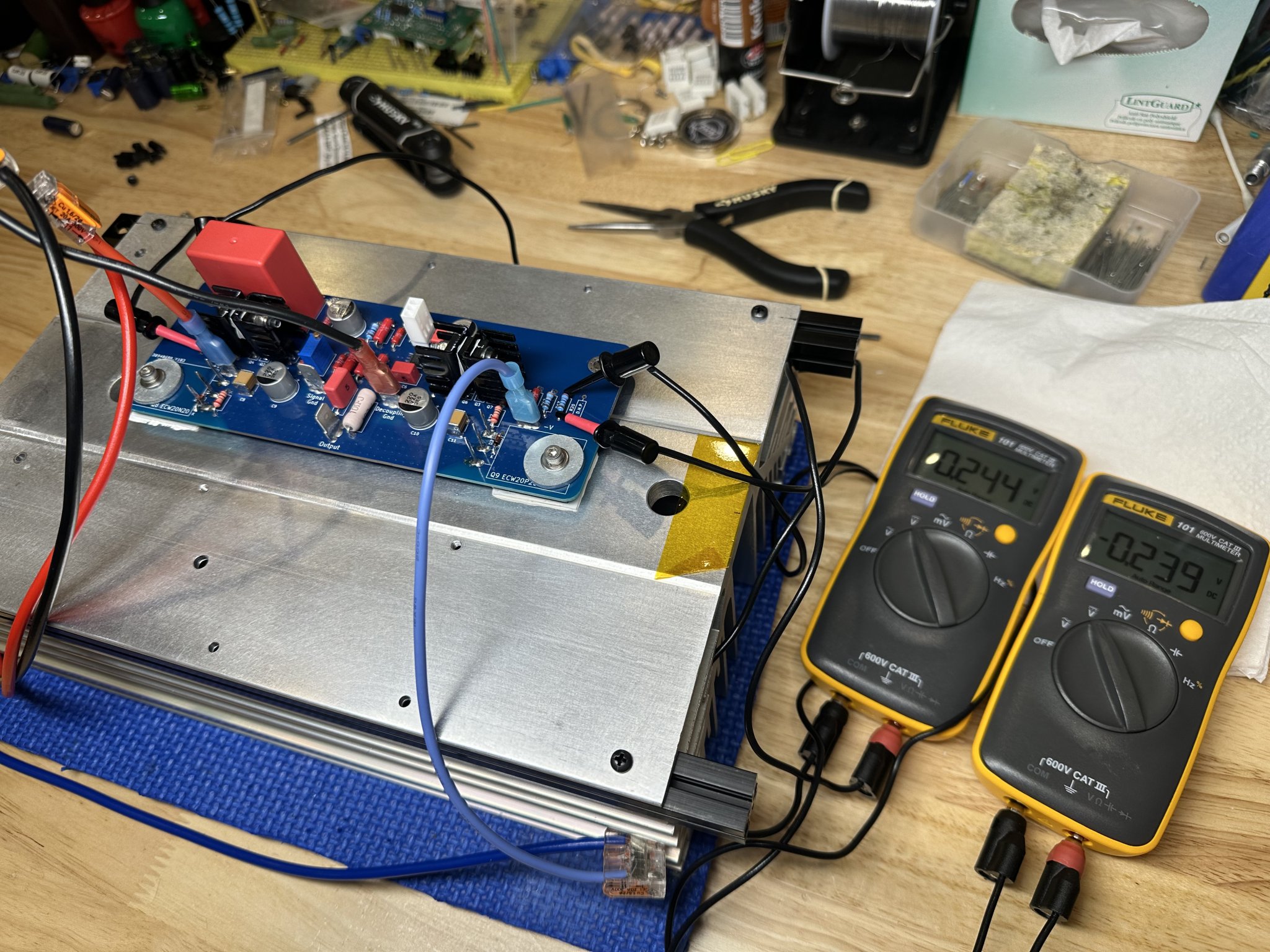

I couldn’t wait any longer, had to fire up the Bliss boards. All went smooth and drama free!😁
Using my DC bench supply set at +/-17V and adjusted the trimpot for 250mV across R16/R17. The current draw is 1.15A per rail with heatsink cold. As it warms up current is slowly decreasing and should settle a bit above 1A. DC offset is nonexistent <1mV.
Getting closer to first sound! Good Times🥳🎄
