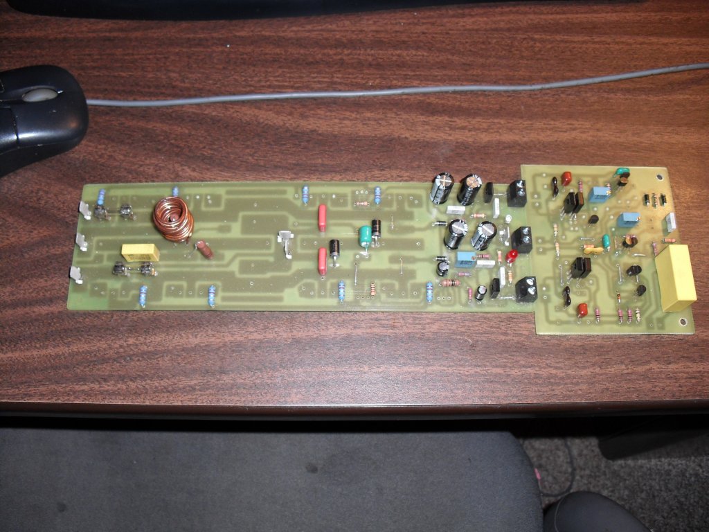

I am using the signature to make it easier for people who participated in Dx group buy to access currently offered Dx PCBs and BoM, also to show my version that I have built recently. My signature barely reflects all my amplifier preferences, Dx Blame is one of them, but my preferences are not only limited to Dx Blame ES, I am using the signature for the sake of group buy participants quick links.

If I remember my high school physics, eddy currents only occur when a conductor cuts the lines of magnetic force i.e. its moving, but that was a long time ago.
I have played around (rather than a scientific experiment) with inductors and sticking a resistor up the centre. In a static envirnoment a carbon resistor didn't effect the actual inductance by much (if any).
I have made a little external PCB to test this further in the future.
regards
Hi wahab,
Excellent thread, a very worthwhile contribution.
Hi, Greg
That s one case,i.e, if the conductor moves, the other case
is when the magnetic field vary in function of time , which
is indeed the case with an audio signal going through the
coil...
