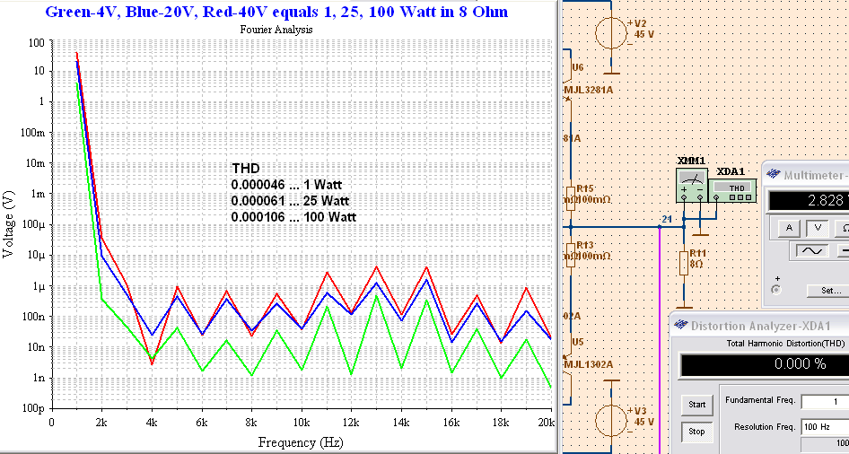

My own best figures for my amplifier design.
Here some simulation to compare with your nice tests, wahab.
I think this is one of my best. Have been working with it last days.
The output stage is 2 parallel pairs MJL3281A/MJL1302A driven in a Diamond.
Idle is 100mA (50mA per device). So we have standard Class AB.
What lower the THD is the frontend.
Input and Feedback and correction of it all is by one OPA134 jfet Opamp.
The OPA134 sets the limit. And it is good.
One step further could be using AD797 or OPA627, which probably would improve a bit.
Supply is +/-45V. THD for 8 Ohm:
0.000046 ... 1 Watt
0.000061 ... 25 Watt (20Vp)
0.000106 ... 100 Watt (40Vp)
The blue curve in my image is the level you often have used.
I use 1kHz and 20 harmonics. It is enough for me.

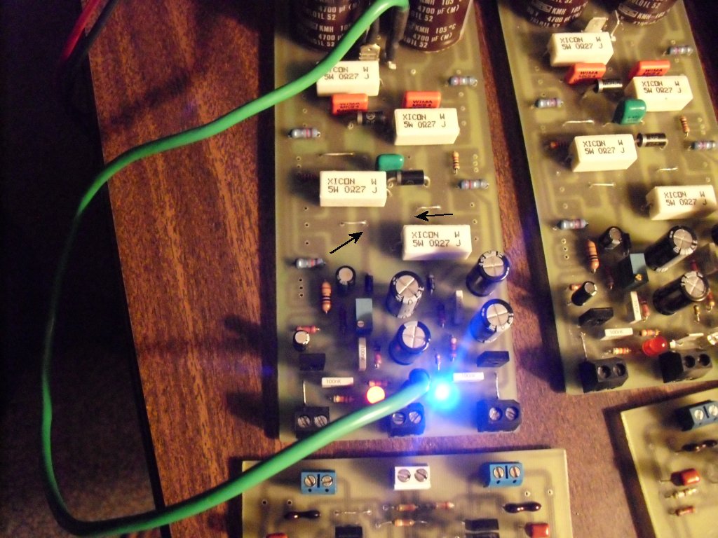

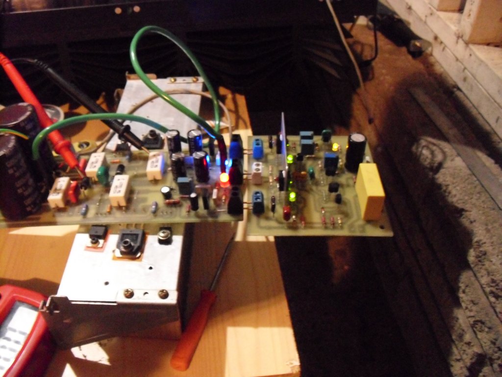

If I remember my high school physics, eddy currents only occur when a conductor cuts the lines of magnetic force i.e. its moving, but that was a long time ago.
I have played around (rather than a scientific experiment) with inductors and sticking a resistor up the centre. In a static envirnoment a carbon resistor didn't effect the actual inductance by much (if any).
I have made a little external PCB to test this further in the future.

No, my test was only: What happens to the value of inductance if I stick different resistors into the middle of it. A static test without a signal going through the coil. The resistors on hand made little if any difference.
wahab is talking about the "changing" signal going through coil producing a magnetic field that induces eddy currents in the resistor. Sounds plausible but is it significant?
My best sounding amps have the resistor in the guts of the inductor, but I have never experimented changing it.

Impressive ratios, indeed..
Just one thing : you should either increase the resolution
or use more cycles to compute the fourier analysis, or both.
If the base frequency is 1KHZ, we should see the curve
going deep between this frequency and its first harmonic, then
surge in direction of the 2khz harmonic level..
Also, it s odd that there s only odd(!) harmonics that
are at a significant level, the even ones being all absent..

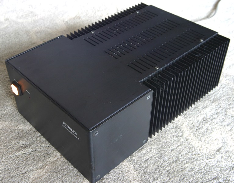

ever seen a japanese amp with the coil wounded around the dumping resistor of an output filter ?
Fidelix LB-4, 1980, Mr. Shin Nakagawa
Even expensive critters for merely 25W amps.
(just for fun : http://www.fidelix.jp/products/LZ-12.pdf )
