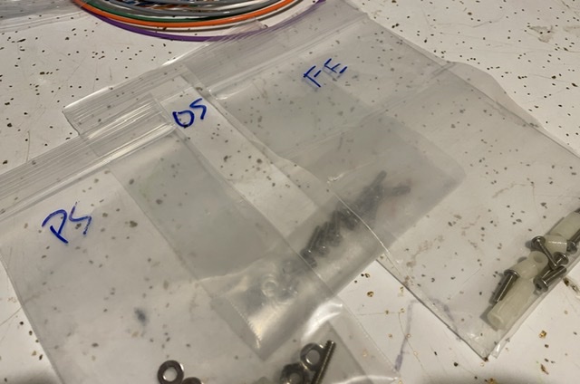

Tip:..Do yourself a favor and label them before you start![]()

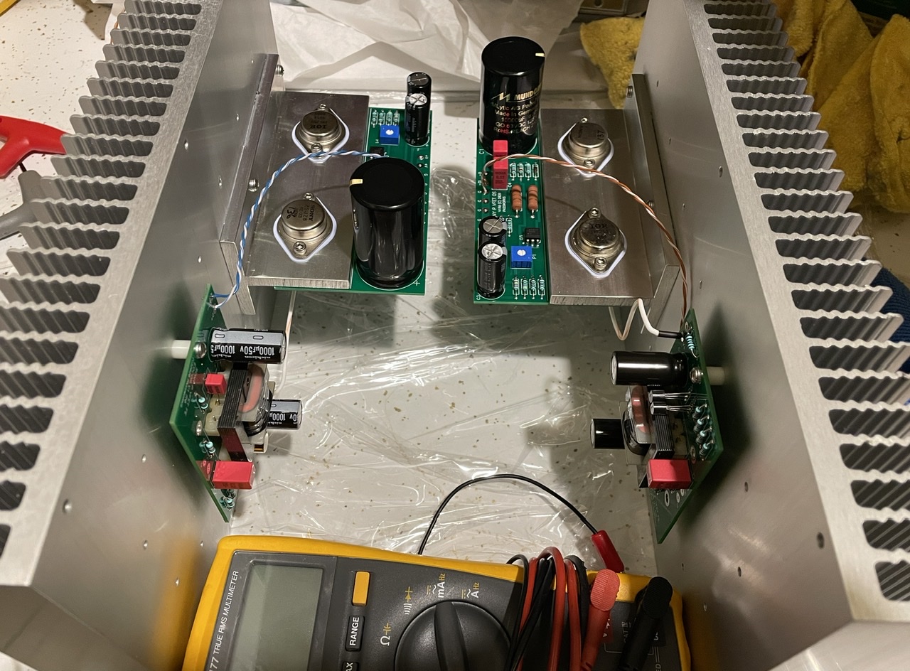

Thx! Haha step by step , psu voltage verification ?
Does LED light glow on the front panel ?
It's blue?
With colours wiring picture find in Mr.Pass article another thing to savorHave a good time on the work bench
Edit: Check details on the high quality 6L6 photos if doubts

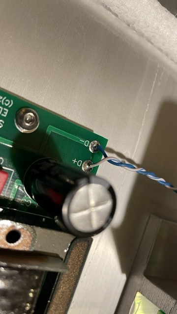

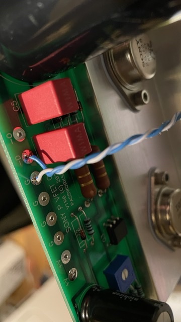

Why does plus power supply from the connector goes to the little filter board, then up to the switch? Would not it be easier from the connector go up to the switch, then to board? Just thinking...
My guess is because that way the filter cap stays charged all the time. Otherwise the switch would have to conduct DC current into a short (charging cap) every time it's thrown, which would wear out the contacts fast. Switching DC is harsh on switches.

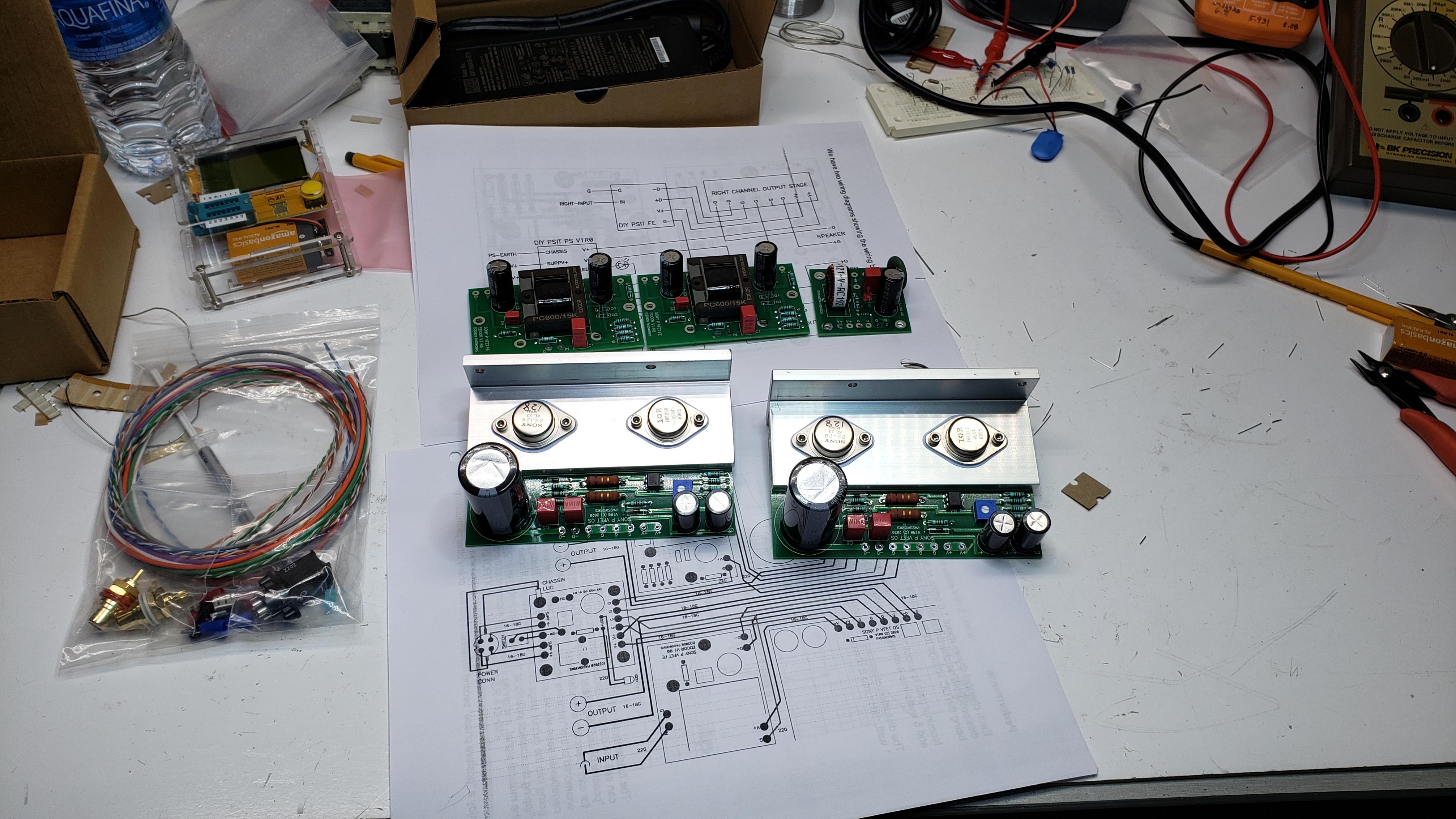

mundorfSlowly starting to look like an amp...
The boards are stuffed. The chassis is in France.
Looking good!
