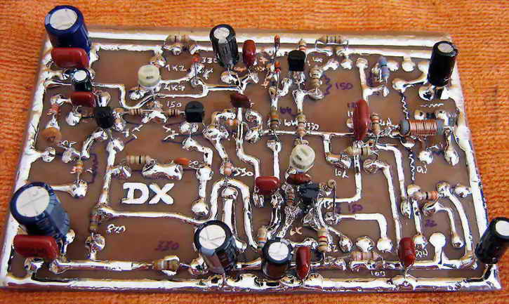

Board is going to the "revision department"... the next door
Using another pen and using new glasses.
I will paint the parts over the board...they will be soldered over the board...when the work was done...alcohol will remove the permanent pen ink (not permanent)
Those parts values, painted, will be the guide to solder the real parts over the cooper....after finished...paint will be removed as will not serve anymore.
regards,
Carlos

Tomorrow it will be sounding if not too much bugs to find.
Here is the board...parts will be soldered over the copper...at the copper side...no holes will be made...board will be glued over the heatsink.
That paint was made to check, to find errors and to be my guide when installing parts.
After that...board will be washed using Kerozene, Alcohol and watter and soap (that one hard..used to clean dogs...the one that can clean even bad thougths)

The amplifier is already built....now is time to search for bug
and to see if it will work fist time or will ask for some work.
I noticed that at least one resistor is missing in the differential...already soldered in place.
Well, it is time to observe and measure resistances searching for shorts, missing parts or other errors.
Yes...i think that this board result awfull...well...i will make better one next time...first, let's see if this unit will work fine.
regards,
Carlos
regards,
Carlos
