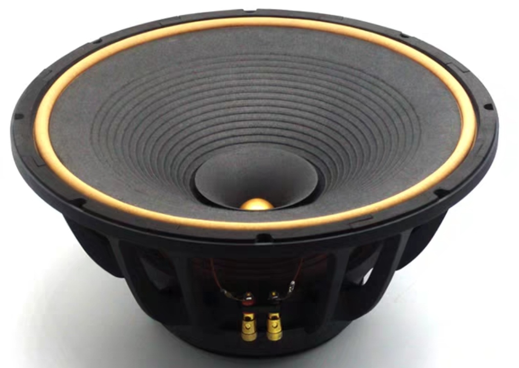

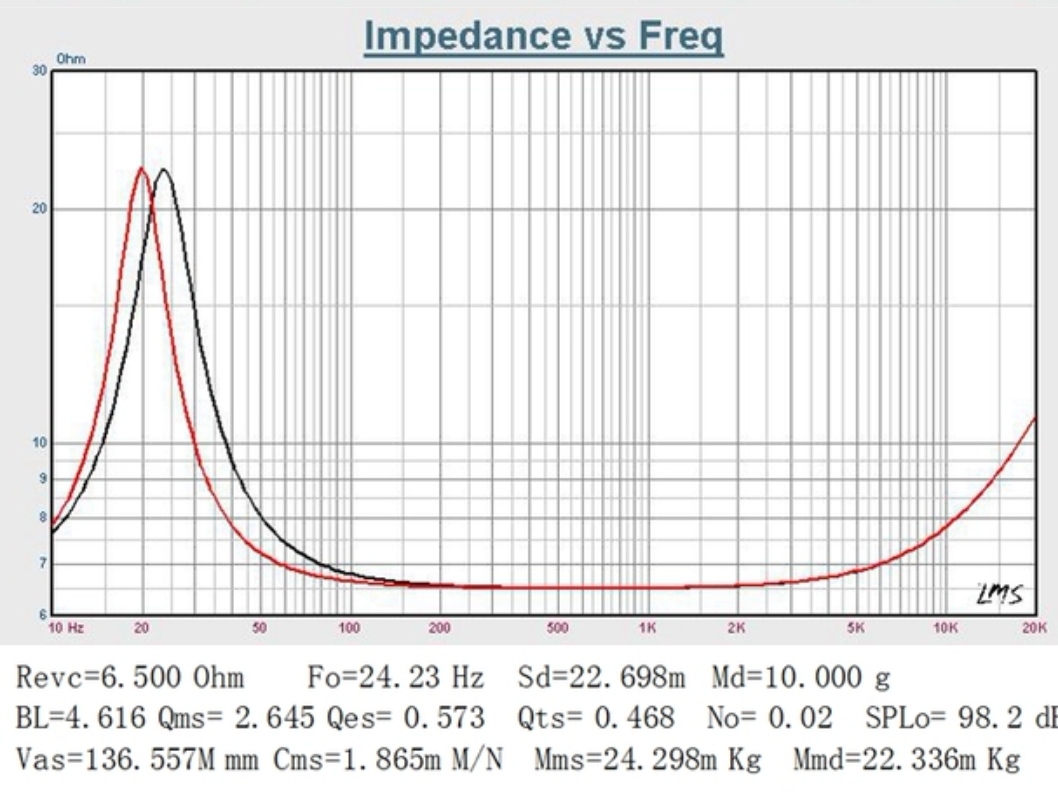

Getting a pair of 15" FR from China for my first big project. TS parameters provided as follows:
It is a new 15" FR by Correct HiFi sold from China
TS:-
60w, 98.2dB, Qts =0.468
Xmas n.a.
Sd 22.698
Fs 24.23
Vas 136.557
Qms 2.645
Qes 0.573
Mms 24.298g
Re 6.5ohm
Le n.a.
Bl 4.616
I have shortlisted a K15 or Karlsonator 15 for it but not sure if this driver is compatible.
Would appreciate if you can run a sim for it and advise accordingly.

here's some perhaps pure fantasy tripled fudged sims based on the black trace of that impedance curve.
Here's the dimensions for Acoustic's little 115BK cabinet. Internal width is 19 inches. Scale 115BK by 1.2X and its
roughly the bulk of K15 and tuned a bit lower. 1.2X size would roughly be 32" high by 16" deep by 24" wide. I think
K would do roughly the same - so the first sim is my guess of how this high end FR15 "might" play in K15.
https://i.imgur.com/z4L1Lob.jpg
