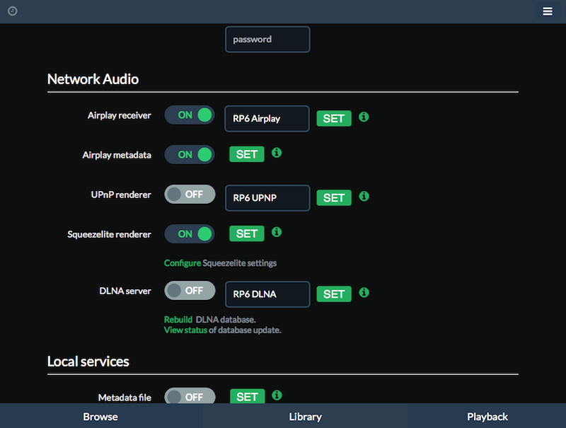

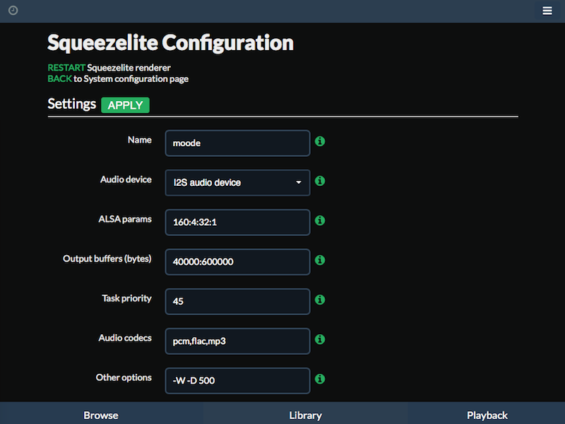

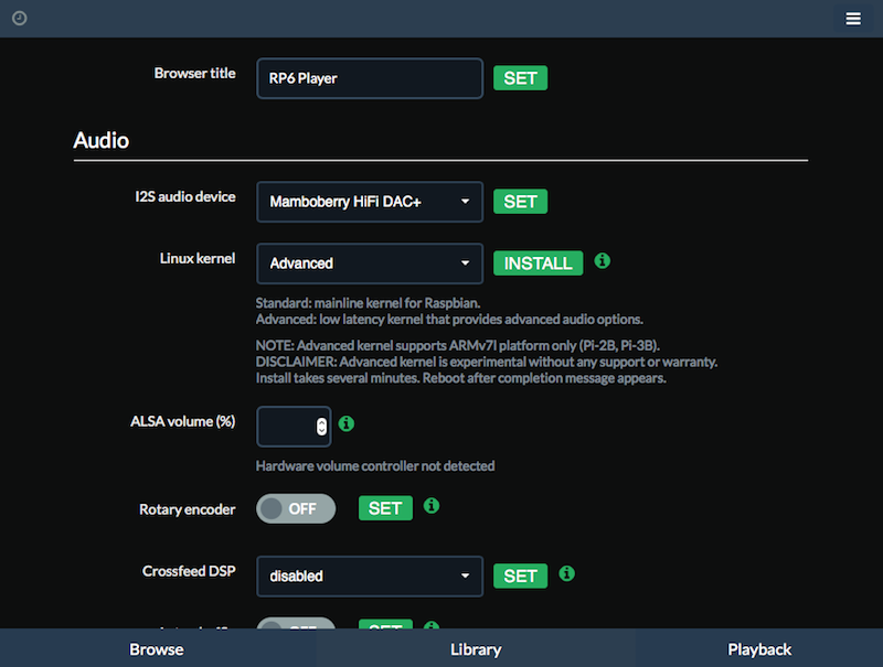

Just a brief update and some updated screen shots. Thanks to one of the inmates, Squeezelite is coming to Moode

Advanced kernel....
Hi Tim - this all looks great - thanks! So, the advanced kernel won't support Pi Zero - but will the other updates to 2.7 still support the Pi Zero, or will that be limited to Pi2 and Pi3 also? Regards Adrian
