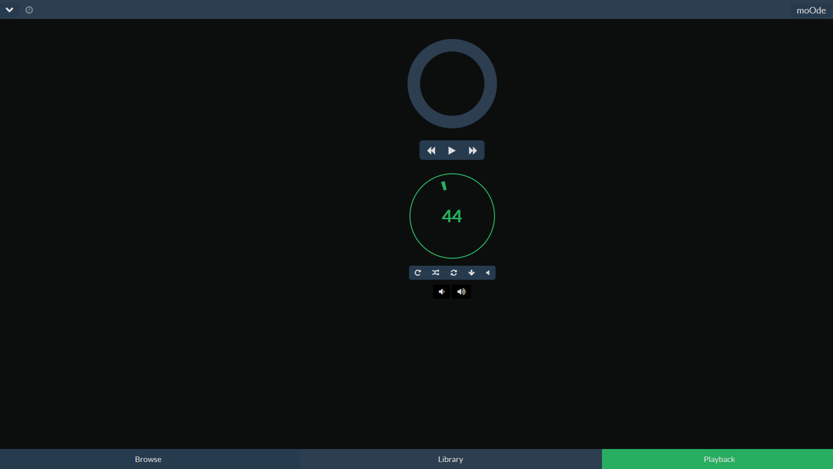

Consume mode - ?issue.
I turned on the auto-shuffle feature which worked when I get to the end of my play list however I cannot turn it off (specifically the consume feature). If I click the consume arrow to turn it off it comes back on when the song changes even when I add new songs it still goes into consume. It keeps toggling back on. I have done a restart and it is still happening.
Not sure if it is me and my understanding of the function - is this a bug or just the way I have been using it? Easiest fix is probably just to turn it off for now.
