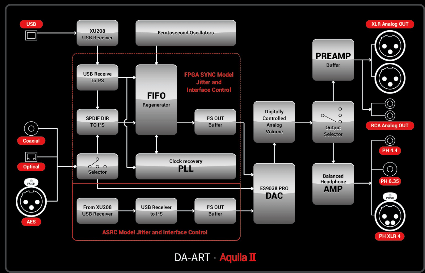

Another fact is, that DACs progressed heavily over the last 10 years.
However. Most of them still respond to upstream "adjustments" and changes.
Have a look e.g. at the Yulong measures to fight the upstream mess.
As you can see a simple USB receiver chip, as being used in many DACs
out there, just won't cut it. It requires serious efforts to isolate from the upstream mess.
It seems, from what I read, Yulong did quite a good job on that part. My last years Gustard A18 DAC
acquisition though, still responds heavily on upstream tunings (usb filters, usb cable, transport tunings, asf.asf.) .
I mean it's a great DAC -- if the upstream mess is gone.
A few DAC manufacturers run these efforts despite the fact that their DACs "measure" well in terms
of "standard" audio measurements. Because what they measure and what they hear are two different subjects.

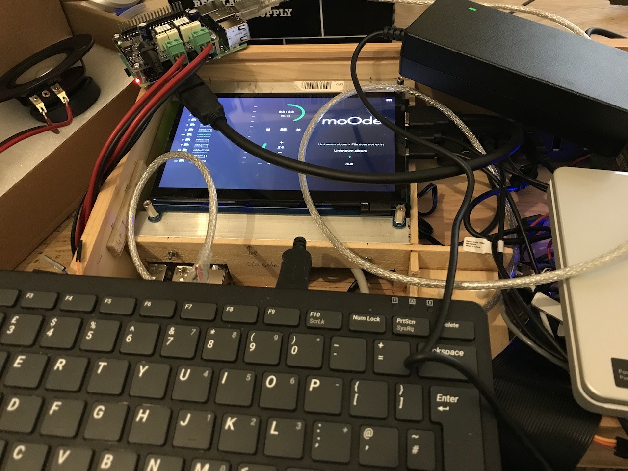

Full test setup of my wife's little not-so-boombox:
CHN50 with DigiAMP+ and RPI4 2GB
7" Touchscreen via HDMI
Meanwell 19V 90W SMPS (model GSM90A19-P1M)
Powered USB2.0 hub
Matek UBEC 7-27V in, 2x 5V 6A out buck regulator.
LG GP70NS50 external DVD/CD drive
The screen is current screwed into a travel box for safekeeping.. I'm buying the ply tomorrow for making the speaker cabinets.
