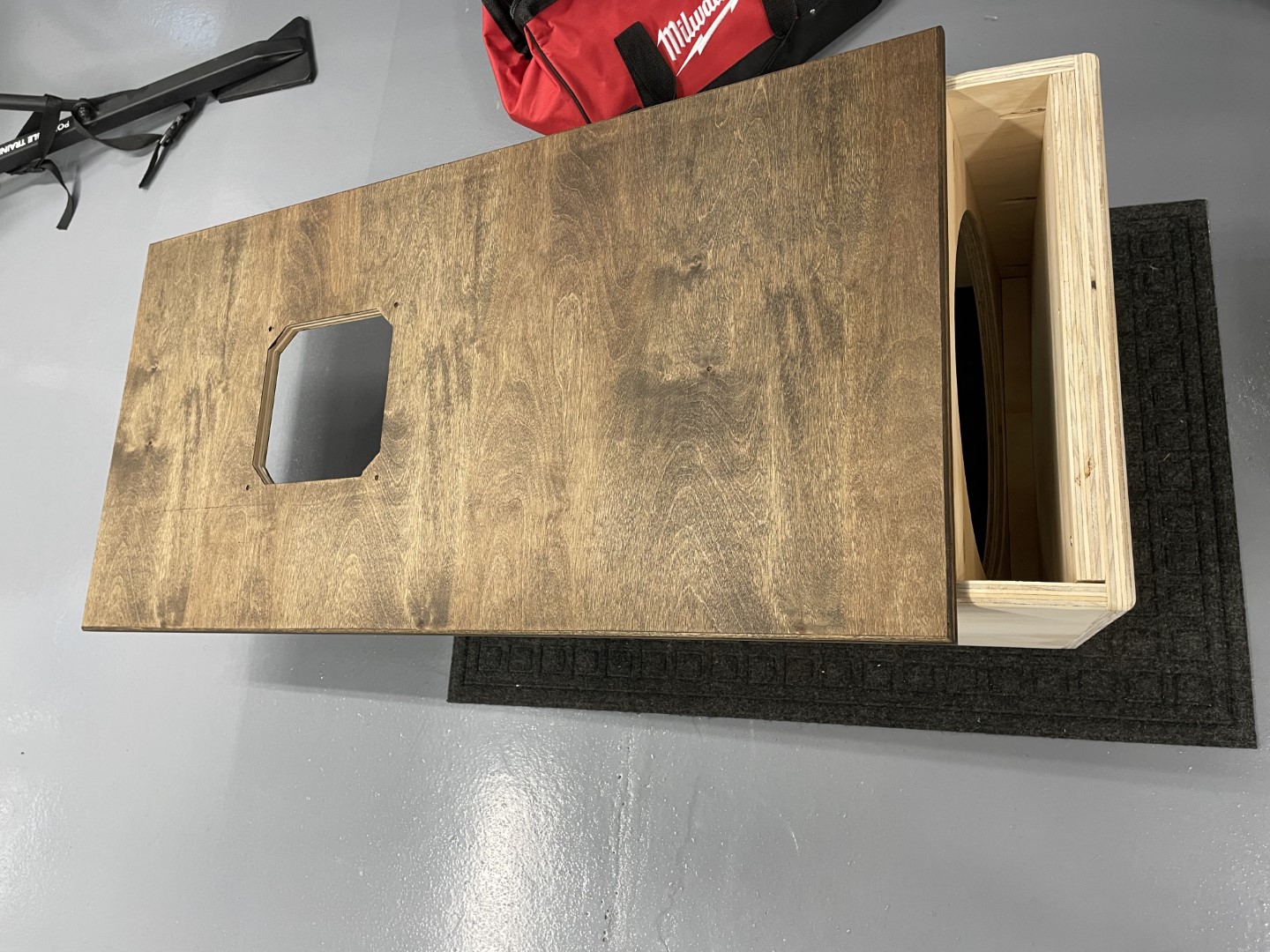

Starting on a prototype build of these myself. Using the Cube Fc8 and the 4015LF. Have the drivers for both, but woodworking skills need some practice, hence the single prototype first. Going to start with Nelson's Cube circuit values first and go from there. It'll be a few weeks yet until we are making music... I hope.
