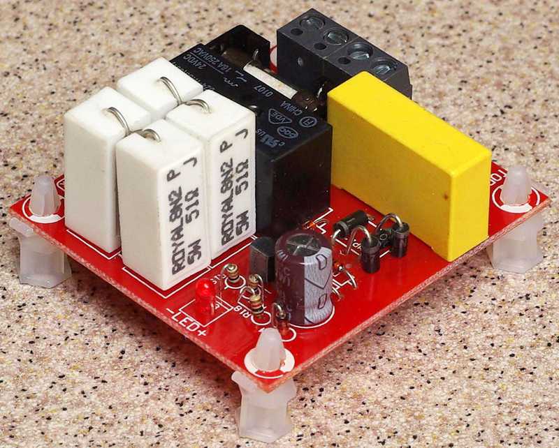

POWER SUPPLIES

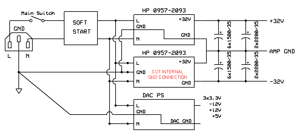

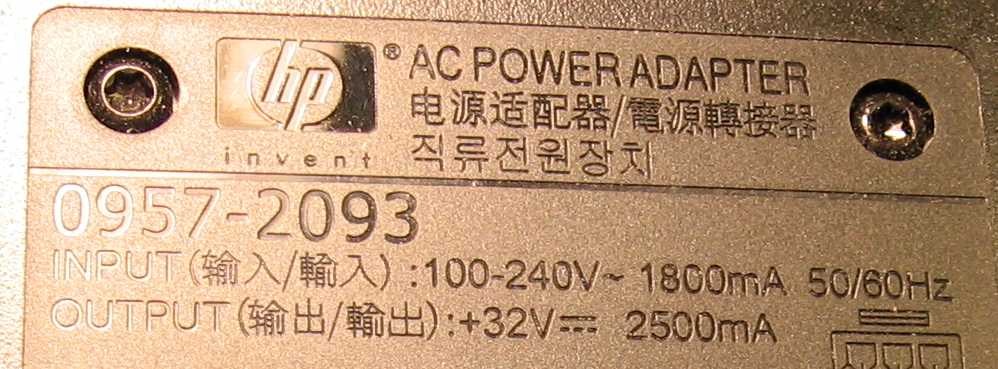

Power supply for the amplifier is made out of two HP 0957-2093 printer power supplies (32V, 2.5A output), removed from their original plastic boxes and fastened together with metal bolts, nuts and plastic isolating spacers. This way they form one unit, producing +32V and -32V needed for the LM4780. Additionally there are two banks of six 1500uF/35V low ESR noise bypass capacitors in parallel at the output of the power supply. They greatly reduce switching noise, which has a peak at a frequency of around 30 kHz. There are also four 2200uF/35V caps soldered directly to the amp boards.
I have chosen the switching mode power supply instead of a classic 50Hz transformer because. SMPS is lighter, smaller, voltage regulated, requires less decoupling capacitance, does not produce any audible hum or spurious magnetic field around it . It’s main disadvantage is production of HF noise, but, as I am going to show later, it is not a big issue when the output is properly...

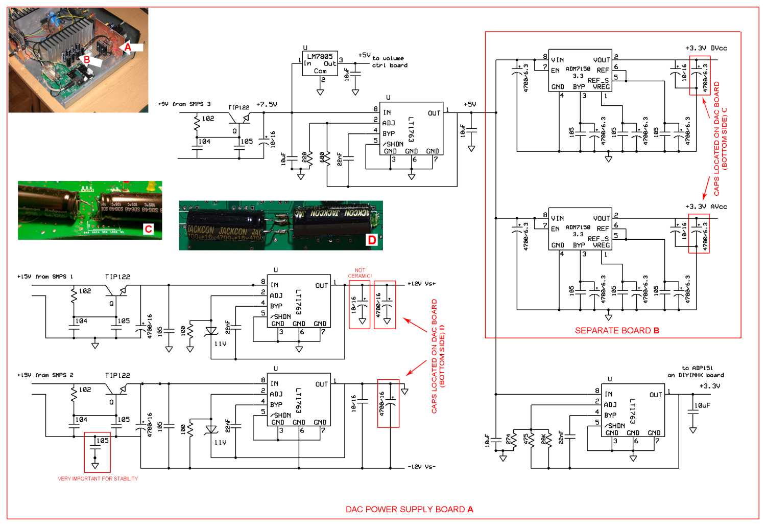

The post-regulation schematics:

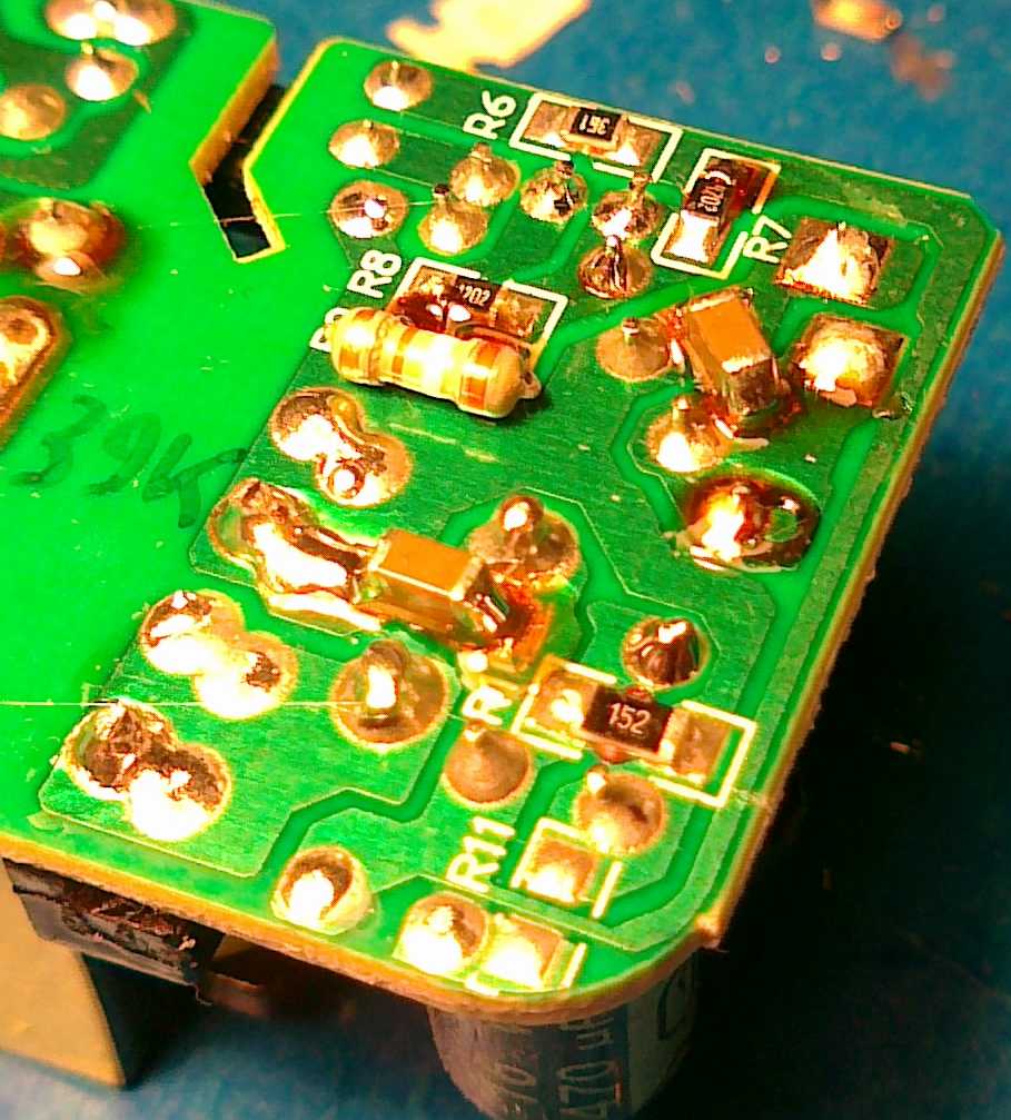

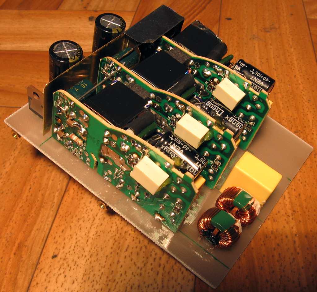

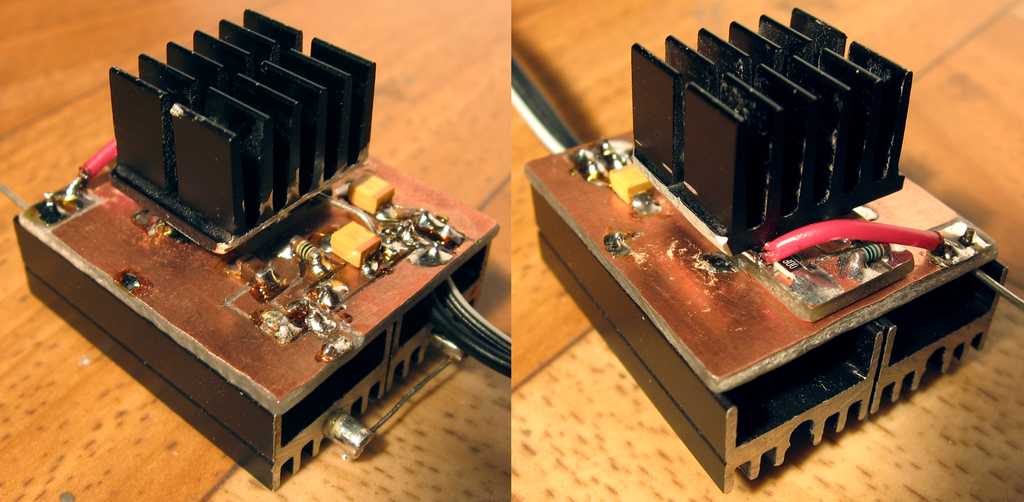

ThreeTHX203 SMPS boards soldered to the main power supply board. There are also additional 230V input filter, output bypass caps and gyrator’s TIP122 visible:
Click image for larger version

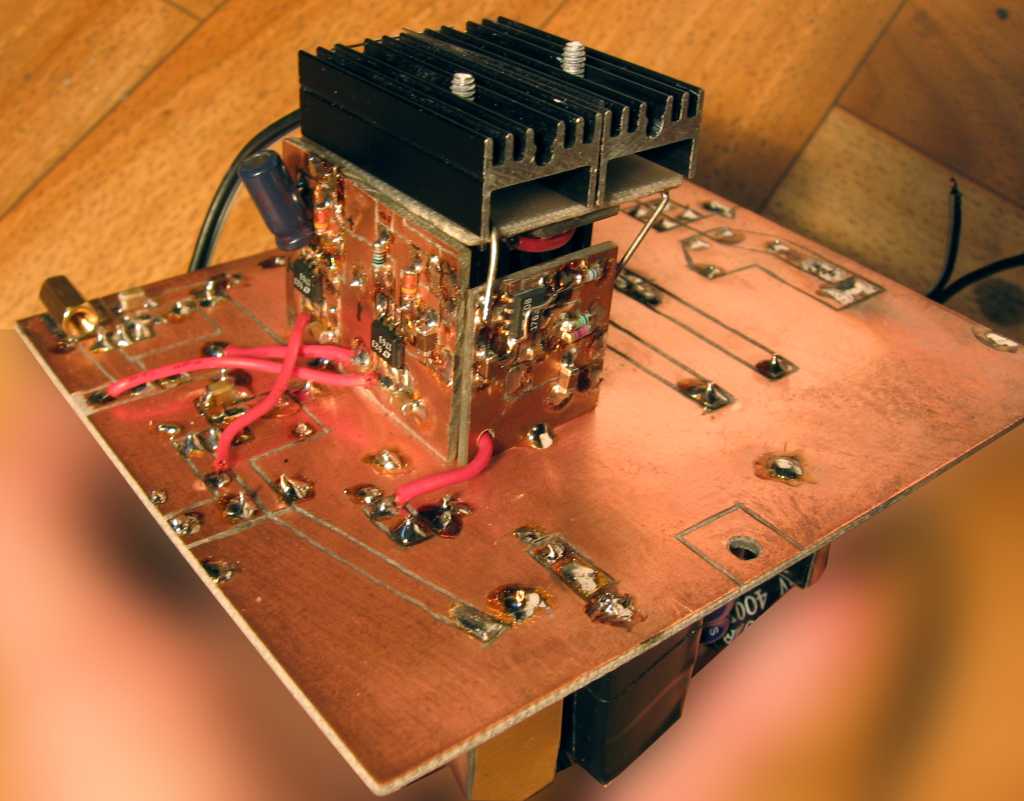

Details of the 5V main power daughterboard. The top heatsink is for the LM1763, the two on the bottom are for TIP122 (gyrator) and LM7805 (5V for volume controller):
ADM7150 3.3V regulators on separate board with Rubycon ZL 4700uF/6.3V low ESR bypass caps (board bottom):

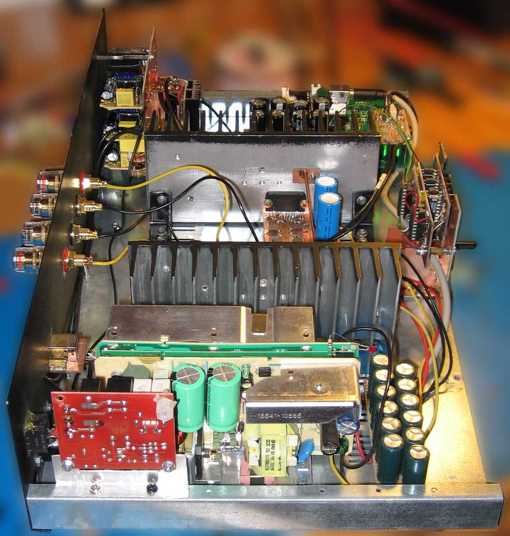

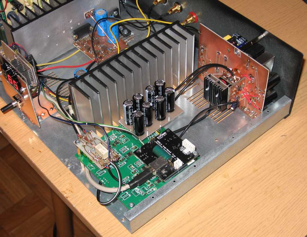

This photos show the how dac power supply is mounted inside the housing:
ID:	1500Click image for larger version

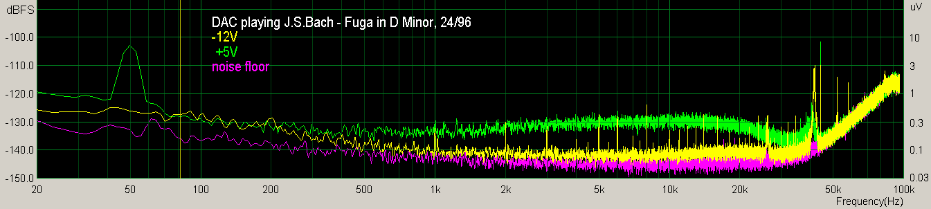

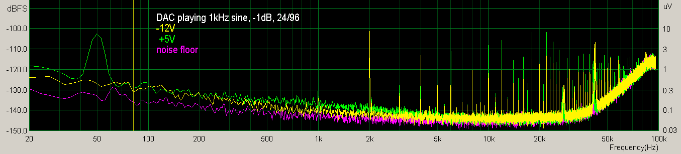

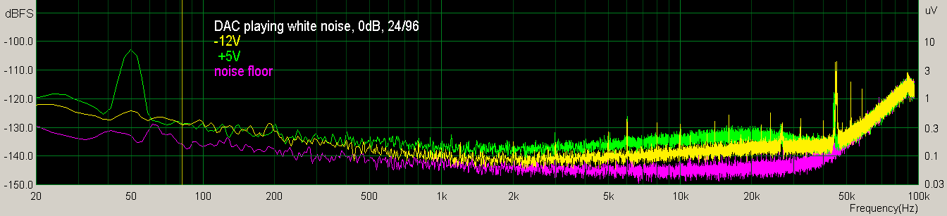

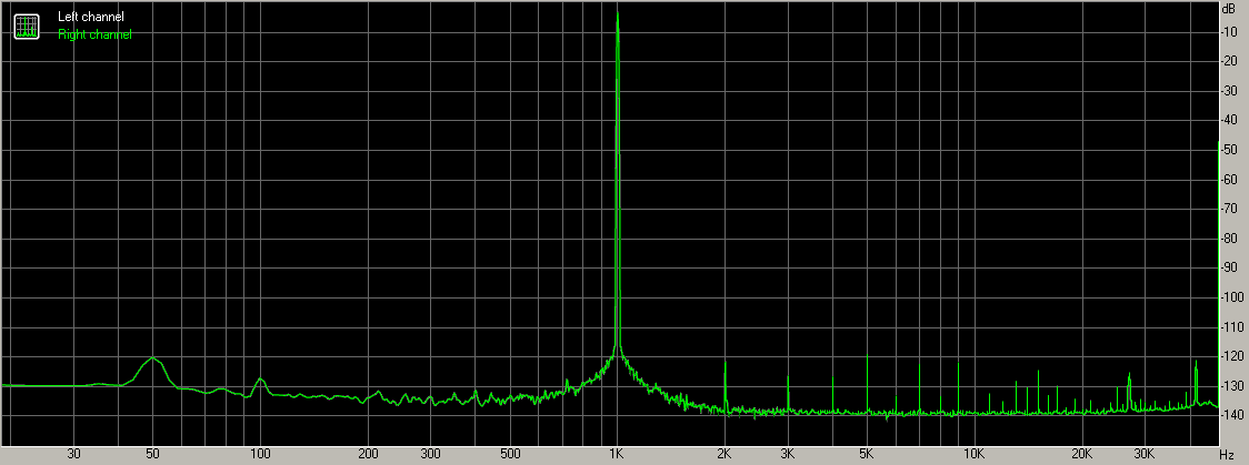

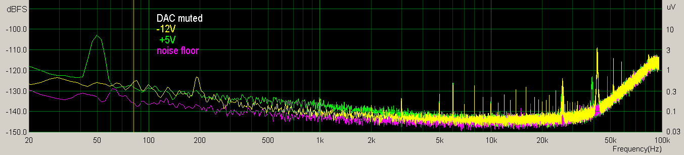

Graphs showing the dac power supply output noise. You can see the SMPS switching frequency noise peaks at 26kHz and 32kHz. Their frequency rise a little when more current is drawn from the supply. It seems that the dac playing 1kHz is an example of the hardest load to regulate for the supply:

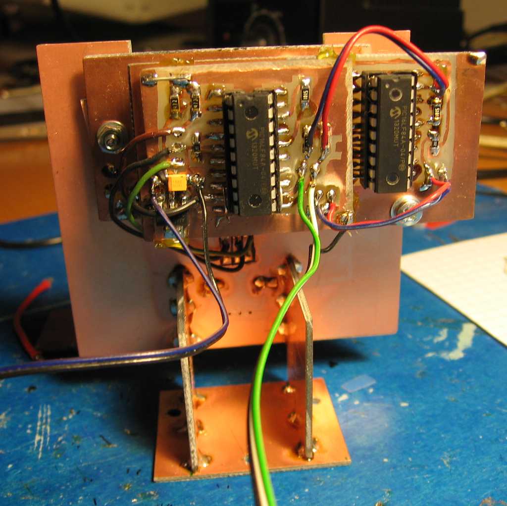

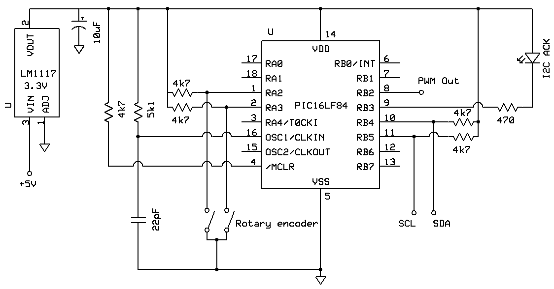

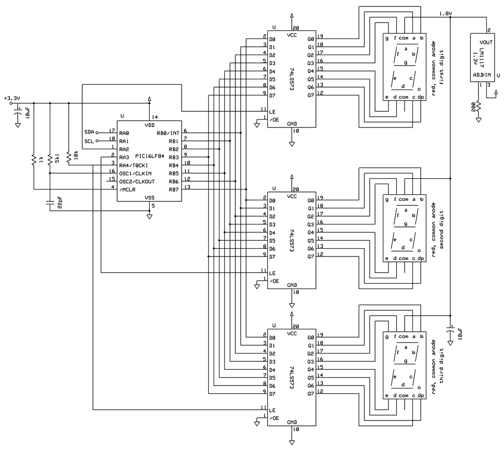

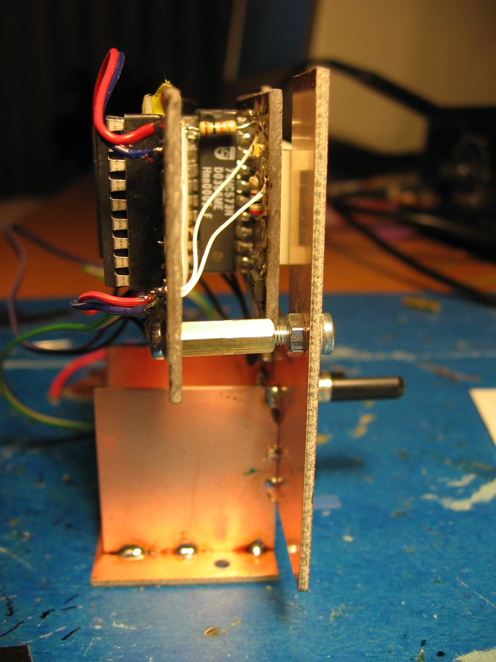

VOLUME CONTROLLER:
It’s a PIC16F84 running a program written by me. It reads rotary encoder and accordingly writes values, via I2C, to the ES9018 attenuation registers. It writes single value to all 8 registers every tick of the encoder. After 10 seconds of no encoder activity, it stores the value to the internal EEPROM of the microcontroller.
The controller board has its own 3.3V regulator, the display board has 1.8V regulator for LEDs
The display module is a separate I2C dumb reader. It catches the attenuation values transmitted...

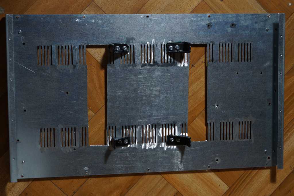

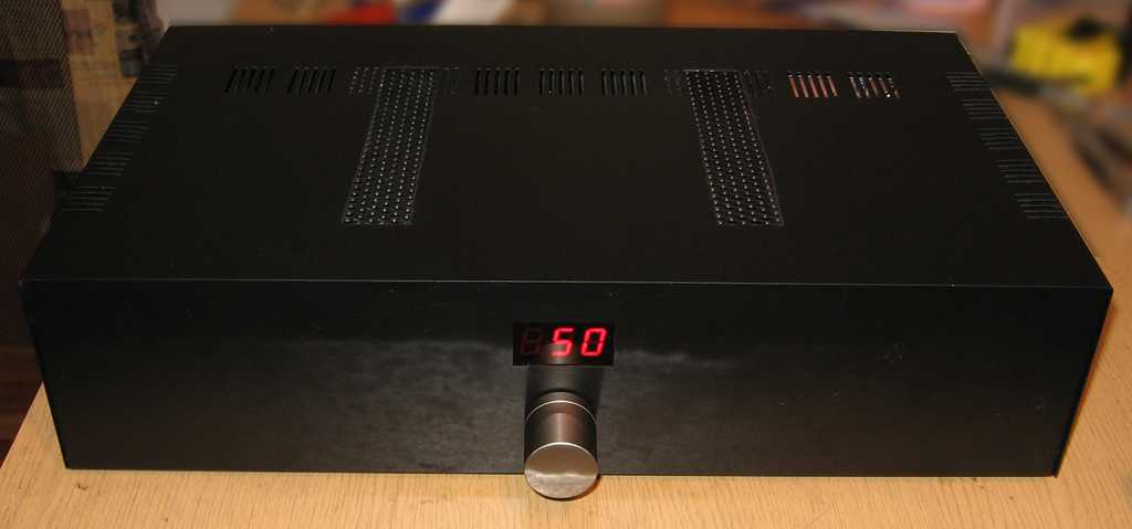

HOUSING:
Typical steel box consists of four pieces bolted together. Dimensions: 440 x 100 x 255 mm (W x H x D). Notice the "Acqua di Gio" volume knob
Bottom piece. I made two holes to let air flow through power amp heatsinks. There are corresponding holes in the top piece. The black plastic pieces are heatsink mountings:

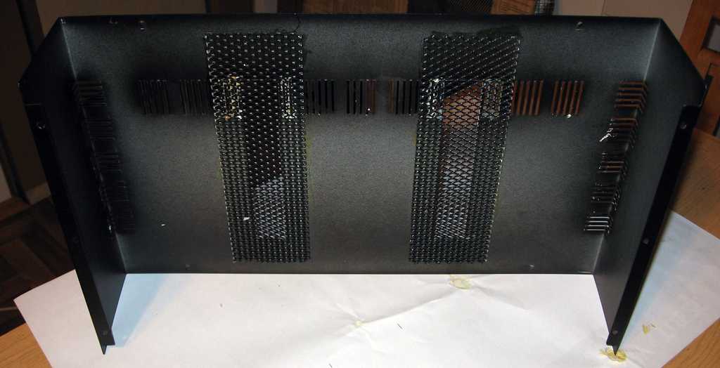

Top cover and side walls form one piece. I glued same aluminum mesh into heatsink airflow holes in order to protect the inside of the housing.
